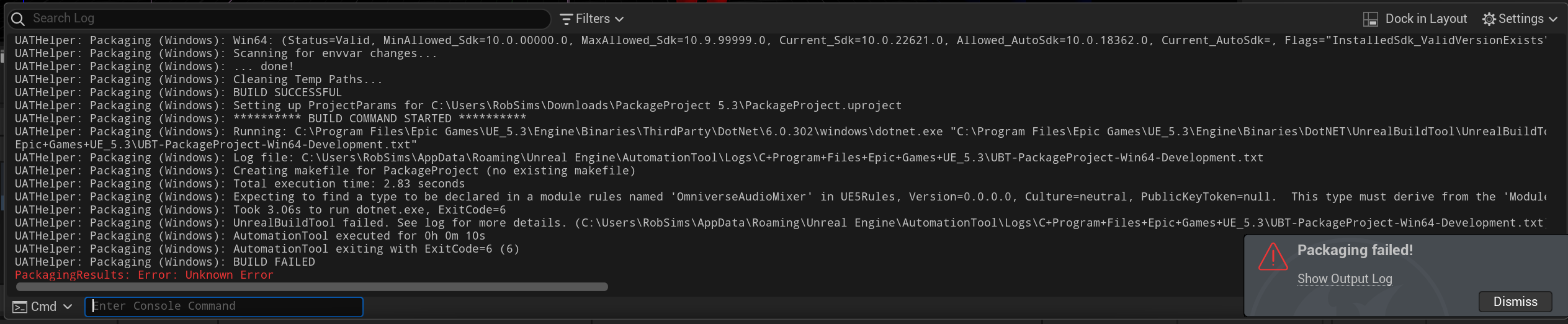

Hey guys, I have the A2F live link set up inside Unreal Engine however whenever I try to package the project inside Unreal with the A2F plugin enabled errors show up and it doesn’t work with an unknown error.
As soon as I disable the A2F plugin it packages perfectly fine.
I have tried this on multiple PCs with different graphics cards and multiple versions of Unreal etc, and at a lose end now as there is no information anywhere on the error.

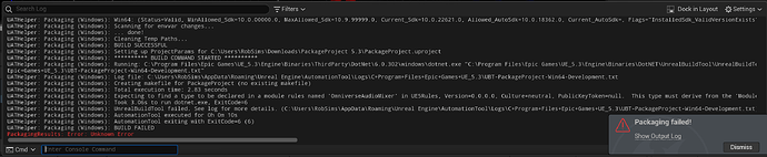

Yes, that is how I have it all set up in a project in 5.3, the same problem happens when I have the A2F plugin enabled in Unreal when trying to package the application, showing an unknown error and it builds completely fine with it disabled.
It looks as if ‘OmniverseAudioMixer’ is the problem with the build.

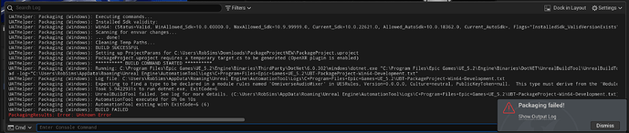

Hey dmohsin thanks for getting back to me, I have installed the frameworks and still the same errors. I have attached the build log.
I have tried this on 3 separate computers and got the same error, is it a problem on my end or are we not able to package a project in Unreal with A2F enabled? Does it work on your side?

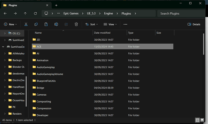

Ah interesting that is strange, I copied the plugin folder from the file explorer audio2faceplugins in to the engine plugins directory like this video (ss attached) → https://www.youtube.com/watch?v=HEFIvFnUfpw please let me know if you need anything else sending over
Lets try this, create a Marketplace folder within the plugins folder and put the ACE plugin there. Additionally you can create a Nvidia folder within the Marketplace folder and put ACE plugin there. So you can try the following root locations for your ACE plugin folder
  1. UE_5.3/Engine/Plugins/Marketplace
  2. UE_5.3/Engine/Plugins/Marketplace/Nvidia
Let me know if this resolves the issue.
That fixed it!!! Thank you so so much dmohsin.
