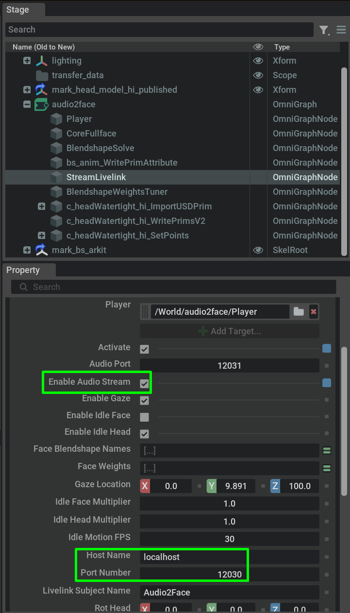

1.- I’m packaging a simple unreal game with one level. In the level there’s a Metahuman character and it has been setup with Live Link as specified in the A2F docs. There is just one camera and also an ambient sound. I have enabled the Omniverse Audio2Face plugin and the PixelStreaming plugin.
2.- I run A2F with the correct ports and settings (Audio Stream).

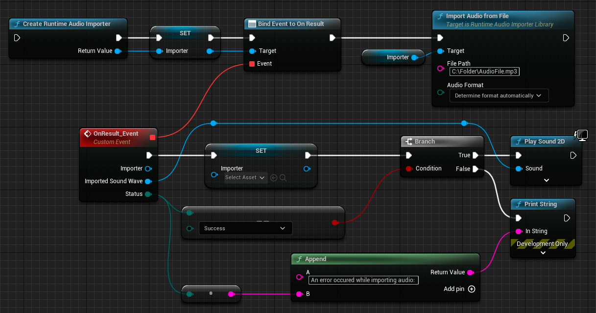

i finally got a work around and now have my Virtual Chat-Gpt Metahuman pixel streaming :)
right before i send the audio file to audio2face i send file location to ue, delay .5 seconds in ue and play the audio. using Runtime audio importer. cheesy, but it works
i mostly do everything in python. Have a widget in ue above the metahuman, the widget sends the input text through a web-socket , then GPT, then whisper, send the mp3 to audio2face and at the same time, send the file name thru a web-socket to ue.
