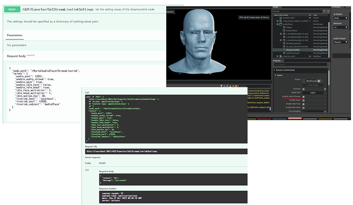

I am experimenting with using rest api in Unreal, and I wanted to set enable audio stream to true, so I set it in SetStreamLiveLinkSettings as shown in the picture, but it does not apply. Any help would be greatly appreciated.

It should work. (I tested on 2023.1.1)
The UI on the property widget might not be update when you executed the restAPI. But try select other node and select it back, and you should see the value is already changed.
thank you I applied it project and found that the UI did not change, but the functions worked.
