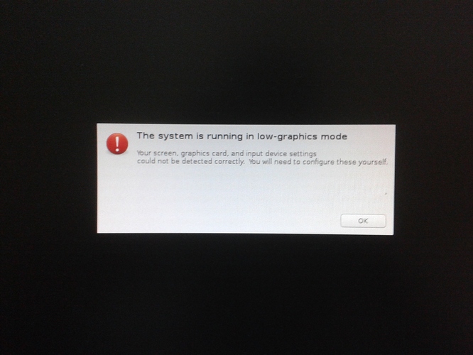

Sometimes when I start the system using nVidia driver 375, 378 and 381.09, the attached message appears, which says that my screen, graphics card and input settings could not be detected correctly. So I press CTRL+ALT+F1 and CTRL+ALT+F7 and I can enter the graphical interface. Does this information indicate another possible new cause of the problem?
