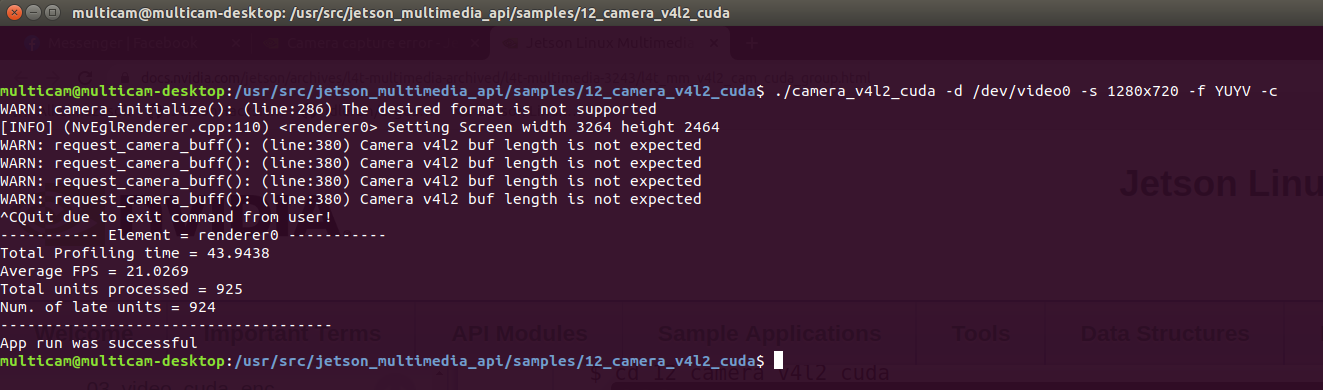

hello extsoltech,
there’s another MMAPI sample, 12_camera_v4l2_cuda to capture images from a V4L2 YUV type of camera and share the image stream with CUDA engines.
i ran the sample, here is the output:
and here is what i see:
i don’t know what happening, before green screen, i see black screen.
So i thinking, the sample not working.

hello extsoltech,
it’s a 10-bit RGGB bayer sensor, you cannot enable 12_camera_v4l2_cuda MMAPI sample since it request for YUV input formats.
please refer to 09_camera_jpeg_capture for demonstration.
thanks
