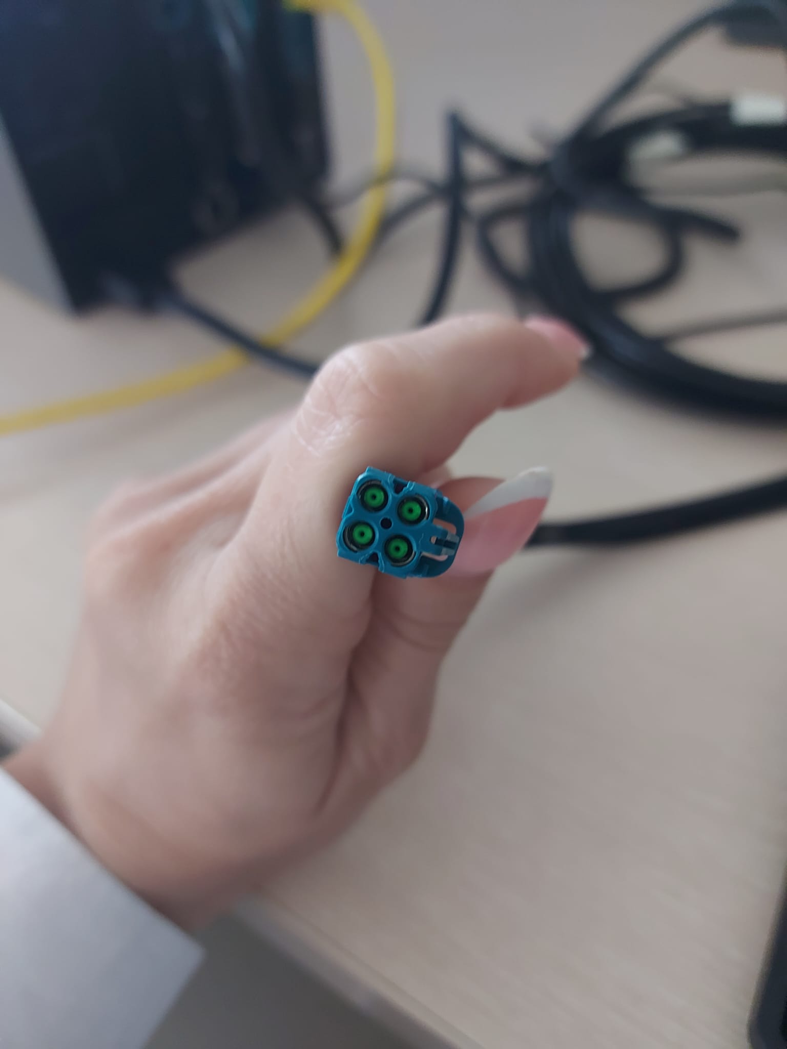

I have problem recognizing the camera, I plugged it the camera via this cable, but cheese doesn’t recognize it or the terminal, is it necessary to install additional drivers or what is the problem with recognizing camera?

Dear @ivana.ivanovic ,
Cheese does not work. Please see the list of supported camera sensors at DRIVE AGX Orin Sensors & Accessories | NVIDIA Developer . Please see the SW/HW contact point for each camera module. You need to get the needed files from the contact to bring up the camera module . Also, check for the supported DRIVE OS version.
