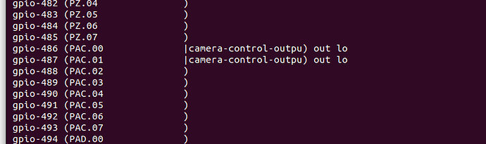

I tried to add an IMX477 camera on AGX Orin, but encountered a GPIO busy problem (gpio_request failed).
By checking /sys/kernel/debug/gpio, I found that the GPIO was occupied by camera-control-output.
I found the definitions related to camera-control-output in the device tree, but I commented them out. The related gpio in /sys/kernel/debug/gpio was still occupied by camera-control-output.
Finally, I tried not to load dtbo. Strangely, the related gpio was still occupied.
What is the reason?

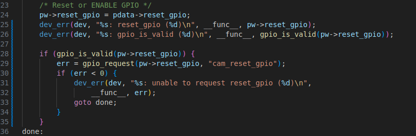

hello t_msg,
let’s try using gpio_is_valid to check this reset_gpio pin before calling gpio_request.
for instance,
if (gpio_is_valid(pw->reset_gpio)) {
    ret = gpio_request(pw->reset_gpio, "cam_reset_gpio");
Same results:

Also, is there any explanation for “GPIO is not referenced in the device tree but is still occupied in /sys/kernel/debug/gpio”?
I think if I figure it out, the problem should be solved.
In addition, I also tested that the unused GPIOs shown in /sys/kernel/debug/gpio can be correctly requested by gpio_request
