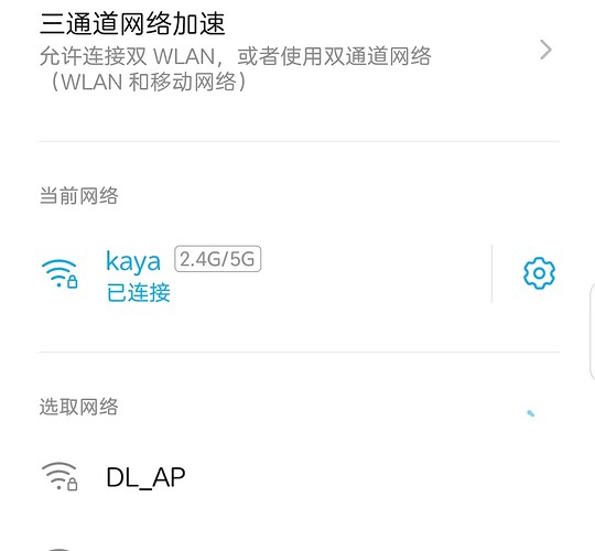

  1. setup the AP on your jetson device with SSID: DL_AP

  1. then you will see the DL_AP hotsport on your notebook or your phone.
    Just connect it with the password: 11223344

Hi @alanz ,
Thanks again for reply!
And sorry again for dummy questions.
Last thing I could not understand from your answers is regarding to the question of whether the jetson is required to be wired (with the ethernet cable) or it can be wireless while setup and running the AP ?
The robot is a mobile one so it cannot be wired to external router.
Highly appreciate your help and answers!!
For nano you can connect a usb cable(macro usb on nano) to your notebook. in that case, you can get a IP 192.168.55.100, you can also access the nano via ssh nano@192.168.55.1. then you can continue to setup the AP.
Another possible ways is configure the AP with uart or a desktop env with mouse/keyboard.
And after the AP configuring , the jetson still must stay wired to the “internet source” for running the AP on it? or it can be mobile?
Totally, it don’t require any extenal ethernet/internet.
Perfect!
Thanks @alanz . I learned something and I’m hoping this is my solution.
