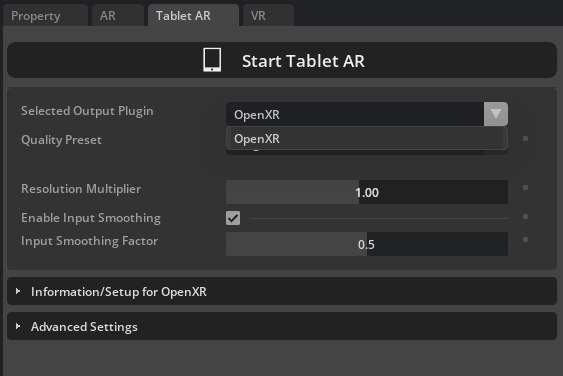

Cannot configure to stream with CloudXR from Omniverse Kit
Greetings!
I am trying to test streaming using CloudXR following this documentation: Cloud XR User Manual — Omniverse Extensions
However, “Selected Output Plugin” dropdown does not have a “CloudXR” option.
I’ve tried adding the following packages to the .kit file and autoloading them, which did not help.

In fact, I have been reading various documentation and tutorials to understand how to stream the kit applications using CloudXR. Therefore, also to receive some guidance, I asked about that option being missing from where it is shown in the CloudXR Manual documentation (screenshot from local given below).
Thank you very much!
(valid for AR and VR tabs as well)
Yes this is because you are using the Kit Base Editor. You are better off with our flagship template, USD Composer. But even then you have to make sure you enable the XR/VR extensions from the Extension Manager.

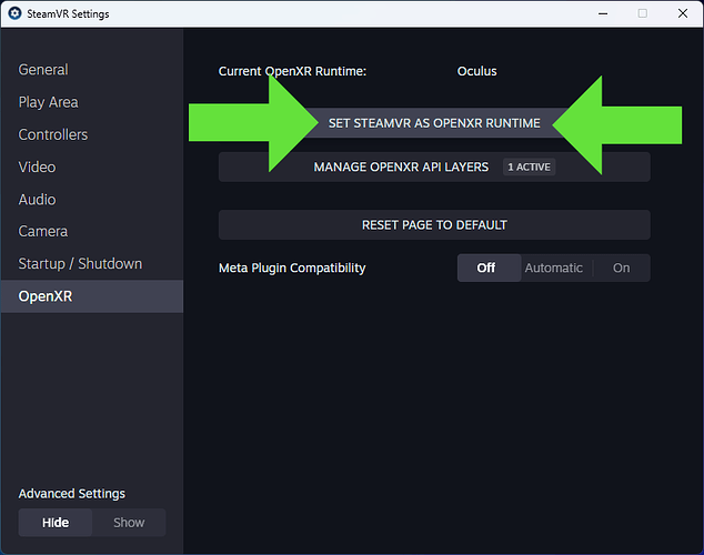

I have a Meta Quest 3S just arrived, but I am encountering common Quest Link issues. I am able to connect the headset to Steam VR, yet again on Omniverse, an option for SteamVR does not appear as well.

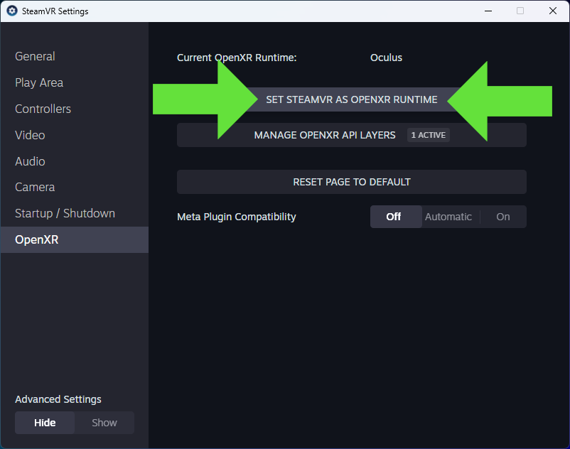

Ok I see the issue now. OK so all you have to do is go to your Steam VR Settings and make your “runtime” use “OpenXR” not SteamVR. Then stick with “OpenXR” in kit and now they should connect just fine.
Here is an article about it
How to set SteamVR as your OpenXR Runtime – LIV Help Desk
Okay, that worked, thank you! I am able to see the output on the headset.

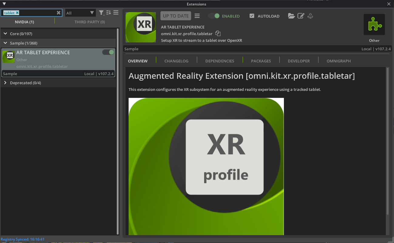

I already have the following extensions in my_company.my_composer.kit file.

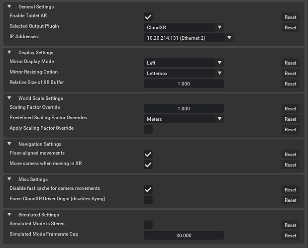

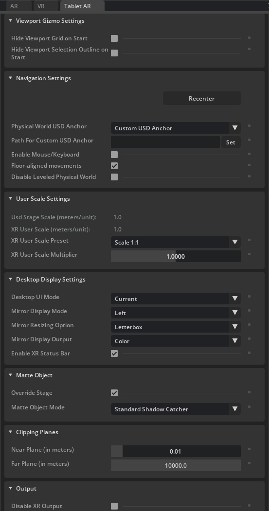

I assume the image you provided is from CloudXR User Manual document. The issue is that I don’t see those panels and settings in Tablet AR window (or VR/AR). Should I look elsewhere? The same guide requires omni.kit.xr extension, which does not exist (see extensions above). I also assume the guide is a little outdated, so I opened the thread.
Actually no. The image I shared last time is directly from my own Composer.

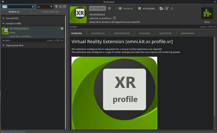

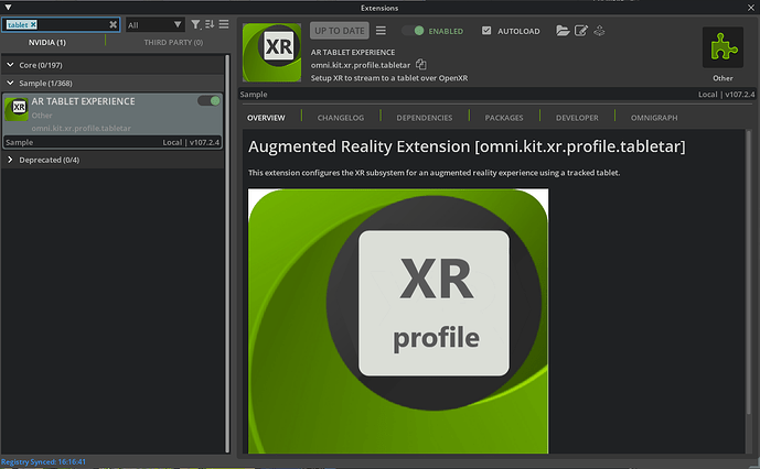

Once you have a default Composer template, just go to Extension Manager and add AR Tablet Experience and VR Experience
@Richard3D , before anything, thank you for your patience. I greatly appreciate it.

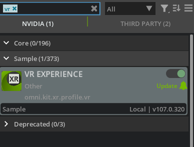

I have just cloned a new kit-app-template repository, checked out at 107.2 branch, created a USD Composer from the template, and added VR/AR/Tablet AR profile extensions you with the same versions in your screenshots (107.2.4). I was using 107.0 before and there the extension versions were 107.0.320 (see the screenshots). I tested with and without application layers.
(Previously used in 107.0)

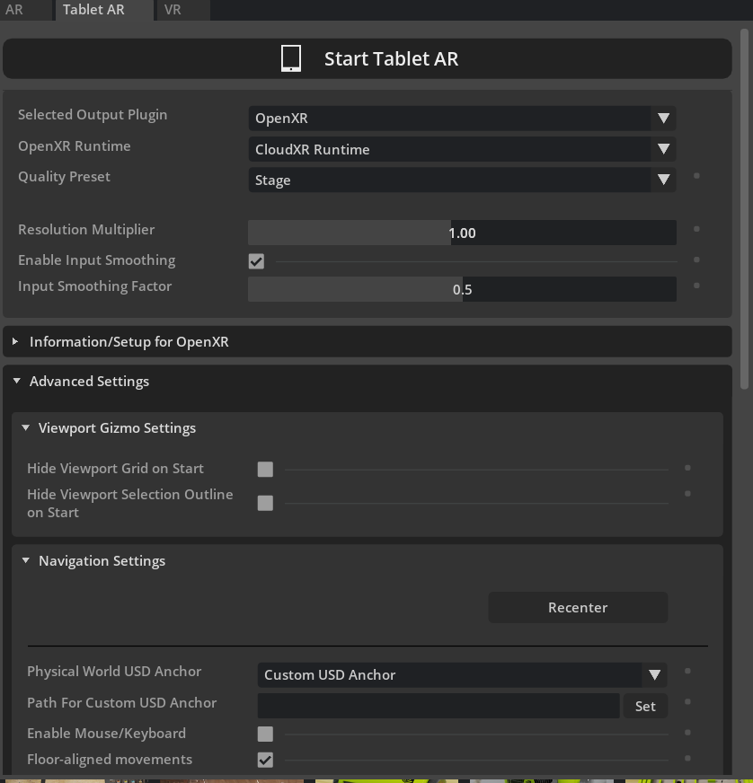

Using extension versions 107.2.4, I am able to see “CloudXR Runtime” option in “OpenXR Runtime” dropdown (see the screenshot). However, “Selected Output Plugin” dropdown still only has “OpenXR” option; and I am still unable to see the panels you’ve shown in the screenshot (General Settings, Display Settings, World Scale Settings etc.). Do I need to look at another window instead of VR/AR/Tablet AR for those panels?

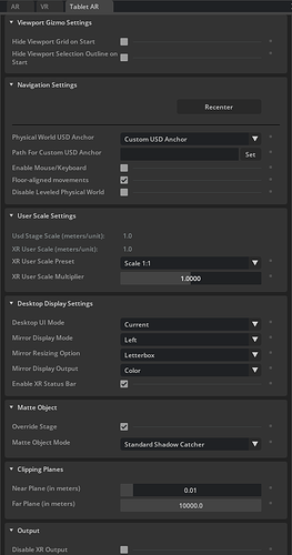

Look in the ADVANCED section of each of the TabletAR and the VR. But I am curious, did the basic VR headset work? Did the basic Tablet AR work? For an iPad you use our App from the App Store. The Nvidia Omniverse Streaming Client
The basic VR headset worked after setting SteamVR as OpenXR runtime (I understand USB connection by “basic”). I could not test with an iPad yet, which I will try as early as tomorrow.
All options in Advanced Settings for both panels:
I have the iPad and Omniverse Streaming Client application, but since I cannot access those panels and configure the app for CloudXR, I could not test streaming.

I have tested with a more performant device, and it helped making progress. I am also able to link the device to the Omniverse scene, using OpenXR runtime (SteamVR as default).

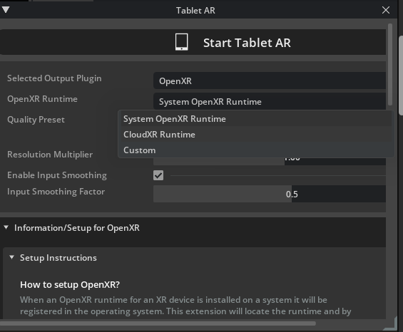

For CloudXR, I have added the dependencies and settings under the .kit file given under “Modify your Kit App Extensions & Settings” section in this documentation. As shown in the image below, “CloudXR Runtime” option appears under “OpenXR Runtime” dropdown. However, the advanced settings are still the same.
When starting Tablet AR (or the others) with CloudXR runtime, I read the following logs in the console. It fails to activate OpenXR service startup.
 INFO [ipc_server_main_common] NVIDIA™ CloudXR™ Runtime 'v5.0.0-beta-rc1' starting up...

2025-05-19 14:32:57 [73,037ms] [Error] [omni.kit.xr.system.openxr.plugin] Service startup failed
2025-05-19 14:32:58 [74,122ms] [Error] [omni.kit.xr.ui.window.viewport.viewport_layer.viewport_layer] Failed to activate OpenXR: Service startup failed
Hope we are close to figuring this out :)
Thank you so very much!
Ok thanks for the log. I have re-read your whole thread he and shown our top engineer. He is telling me that CloudXR only works on an Apple Vision Pro or an iPad at the moment. Do you have one of those two things?
