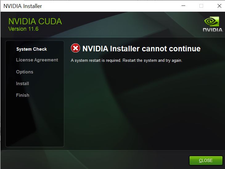

Can't install CUDA Ver 11.6
I was alerted that I did not have CUDA 11.6 when executing a Python Tensor Flow script.
.I got the error:
2022-01-25 13:09:56.497441: W tensorflow/stream_executor/platform/default/dso_loader.cc:64] Could not load dynamic library ‘cudart64_110.dll’; dlerror: cudart64_110.dll not found
as shown below
I’m running Windows 10 Pro and have a 1080 GPU.
CUDA v10.1 is currently installed
I have attempted to install 11.6 several times:
Restarting has not helped.
Tech support suggested I run System File Checker tool (SFC.exe).
I have
I first ran DISM.exe /Online /Cleanup-Image /RestoreHealth /Source: C:\RepairSource\Windows /LimitAccess
This seemed to succeed
Next I ran the SFC tool
Scannow
This also worked.
I restarted the system and tried the NVIDIA installer agin.
Same problem Can’t Continue.
Please advise on how I can get CUDA v11.6 installed.

Did you use local installer cuda_11.6.0_511.23_windows.exe or network cuda_11.6.0_windows_network.exe?
https://developer.nvidia.com/cuda-downloads?target_os=Windows&target_arch=x86_64&target_version=10&target_type=exe_local
I have tried both

Problem solved
I was selecting windows 11 when I run windows 10 (duh)
