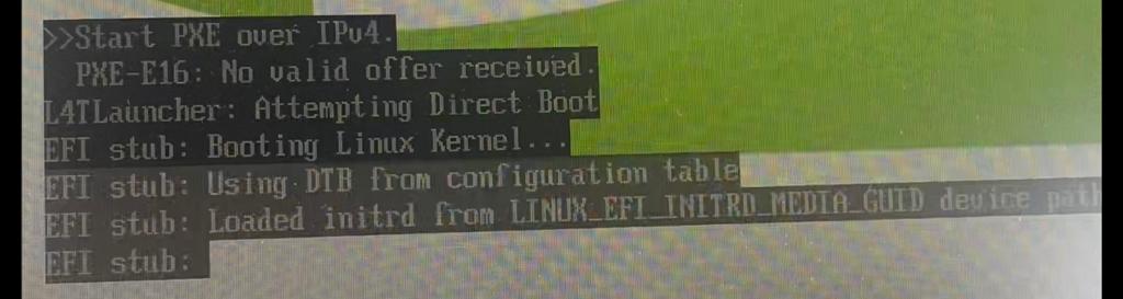

I am trying to clone Jetson Orin Nano (p3767-0003) from one device to all others, but experience big problems.
Used custom board from seedstudio
At first made an image with ./tools/backup_restore/l4t_backup_restore.sh -b p3509-a02+p3767-0000 and then restore via ./tools/backup_restore/l4t_backup_restore.sh -r p3509-a02+p3767-0000 with changed all scripts inside backup_restore directory as written here
Essentialy search and replace mmcblk0 → nvme0n1
After success flashing second device it, remove jumper and boot, come this screen with error which takes ~5min and then normal boot

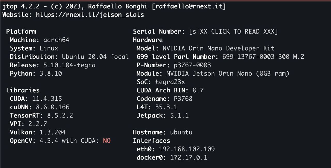

Jetson info

Google says can be problem with boot order, but how to fix it?
Is there better way to clone orin nano one to many?
during boot up, uefi will tell you to press escape to enter the uefi boot menu. You can modify the boot order using the menu.
Another way is, once you boot up, you can use efibootmgr utility to modify the boot order.
Thank you for quick respond, change boot order resolved the problem, by why it happening? Any chance to fix it automatically after clonning via some commands?
I think you can change the boot order on the original device so the clone image would have the correct boot order.

After clone become
I see. After cloning, the SSD ID change so it gets added to the end of the boot order.
If you use Jetpack 5.1.1, You can flash you original device with environment variable set:
OVERLAY_DTB_FILE=“BootOrderNvme.dtbo”
so it will priotize booting from NVMe. However, because you use a custom board, I am not sure if the vendor BSP has that feature enabled. In that case, your only option is changing the boot order manually.
