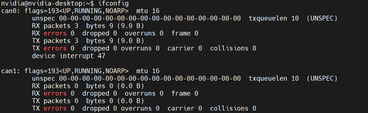

I am configuring mcp2515 on R35.1 and restarting the development board after completion. Using the ifconfig command, I can see the configured can1. However, during loopback testing, I used cansend to send data, but candump did not receive it.What are the solutions available,thank you!

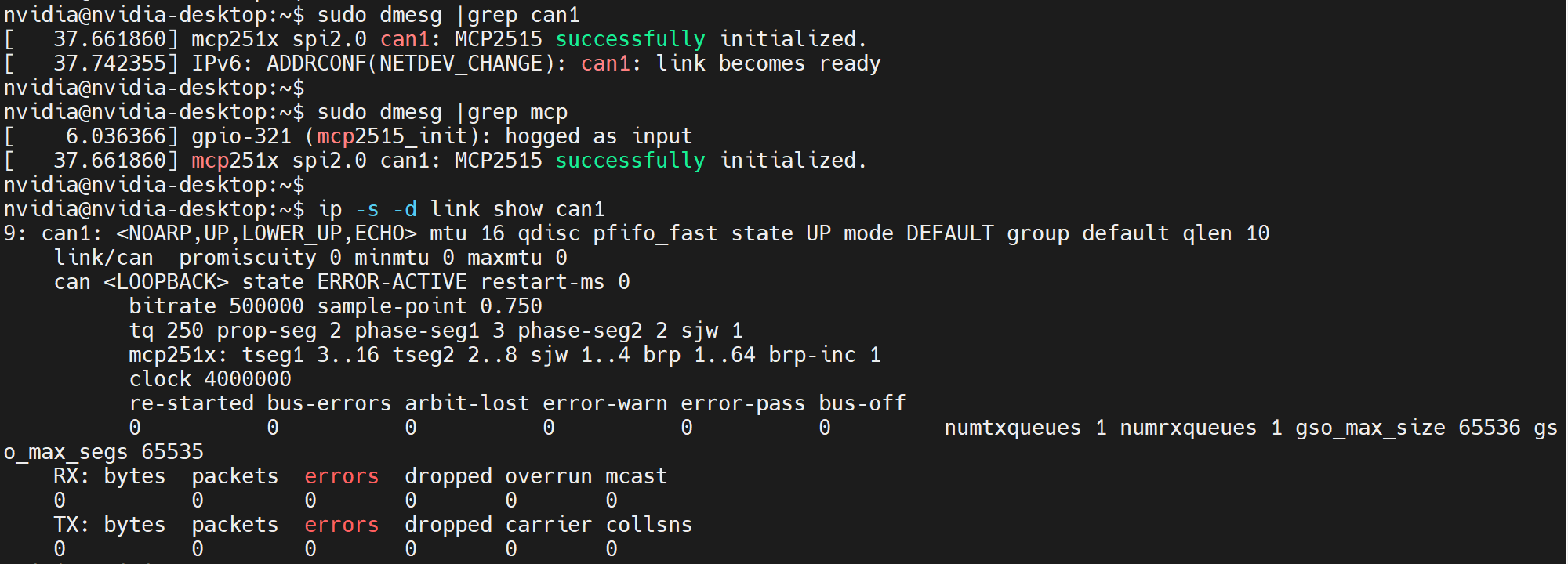

sudo modprobe mcp251x
sudo ip link set can1 type can bitrate 500000 loopback on
sudo ip link set up can1

Could you also share the dmesg for further check?
Could you help to compare if the pinmux for SPI different between R32.7.1 and R35.3.1?
dmesg.c (67.9 KB)

The pinmux values of GPIO12 connected to pin INT of mcp2515 chip are all 0x5a
Hello, after comparing the interrupt allocation between the two versions, there are some differences: in R32.7.1, mcp251x was assigned an interrupt; In R35.1, spi2.0 has been assigned interrupts, which are theoretically the same program, but do you know if there is a difference?
r32.7.1-interrupts.c (16.8 KB)
r35.1-interrupts.c (10.2 KB)

I found can0 is the default can bus, which come with internal loopback and could be verified with the steps from the developer guide.
can1 is from mcp2515, how do you verify it with loopback test?
Could you share any block diagram of your connections and every command you used to setup can1 and transmission?
In the above reply, first load the driver and set the loopback.
The ‘candump can1’ command receives data,and the ‘cansend can1 123#1234’ command sends data. However, candump cannot receive data
