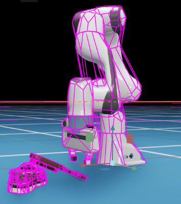

I found a work-around by using get_physx_simulation_interface().get_contact_report() instead. It gives me the current state. It was not mentioned anywhere in the documentation though, I discovered it in ContactReportImmediateAPIDemo within kit>extPhysics → demos
Surprisingly, this work-around does not report all collisions either -
I simulated robot pick of brush (which is reported), collision of brush with shoe (not reported). The only difference between the shoe and the brush in terms of spawning is that the shoe is spawned via URDF while the Brush is a USD file.

The contact report only reports contact between /World/brush - /World/RPL_Franka/panda_rightfinger and
/World/brush - /World/RPL_Franka/panda_leftfinger, not with /World/demo_shoe. At some point in the pickup, also reported /World/RPL_Franka/panda_leftfinger - /World/defaultGroundPlane/GroundPlane/CollisionPlane
Finally, I figured out that importing from URDF through script does not add Contact Reporter API, while importing URDF via GUI does…>.< . FIXED in code (Note: using prim.prim because I have a custom prim type that encompasses RigidPrim)
