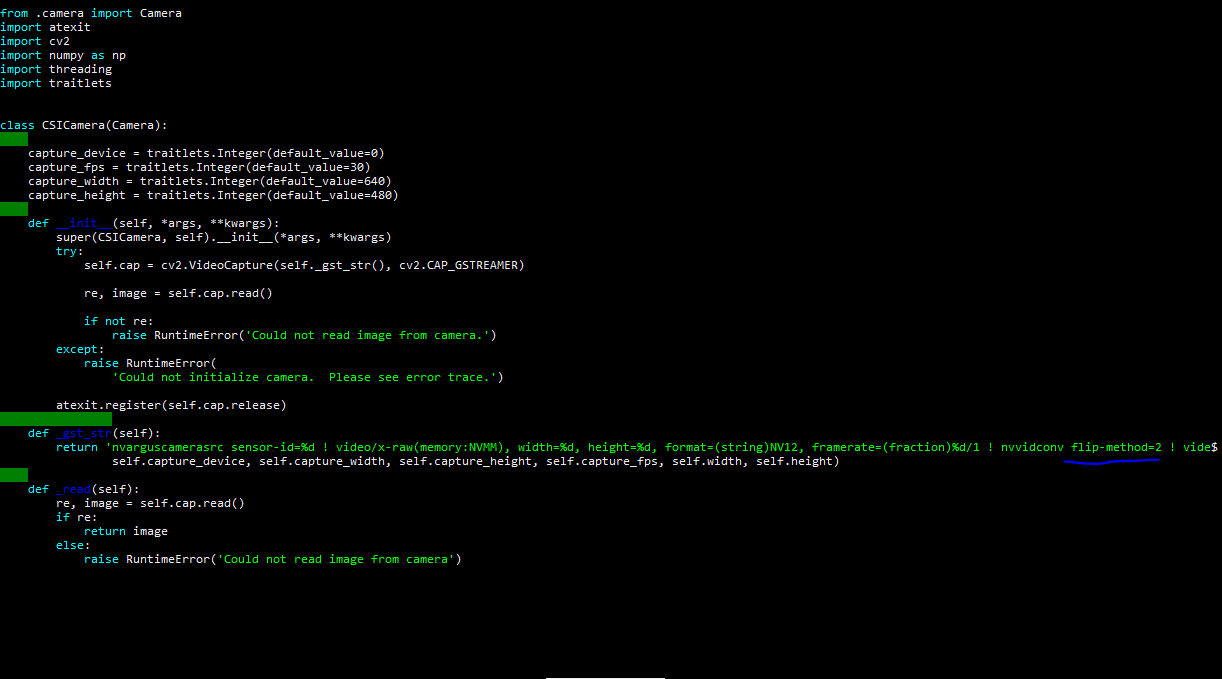

If you want to set the flip-method inside of the DLI notebooks, please see this post:
Hi, Have make the changes , the last step python3 setup.py install, I had installinstall pytho3, but is showing I have python 2.7.
I had reboot PC, disconnect the camera connect again.
looks the same…
Hi @jonathan3110, sorry for the delay - you would need to do those steps inside the container. After you start the container, you will be given a root prompt (# symbol). That prompt is running inside the container. Then clone jetcam from that prompt, make the edits to set the desired flip-method (using text editor inside the container like nano or vi), and then install it in the container with python3 - all from that container prompt.

OK gotcha. You may have already found this, but in Hello AI World programs you can simply use the --input-flip=rotate-180 command-line argument to flip the camera image. For more info, see here:
https://github.com/dusty-nv/jetson-inference/blob/master/docs/aux-streaming.md#input-options
