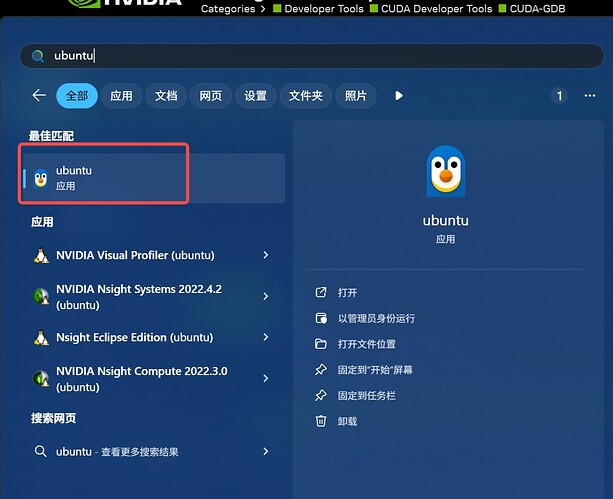

In powershell, are you using “$wsl” to enter directly ?
Asking this because we have known issue if enter into WSL by remote SSH.
I type “ubuntu” in Windows start menu, and uses the powershell terminal it provides.
I’m not sure if it has the same effect as the way you mentioned.
Hi, @1154330861
Thanks for the response ! Then this is not the same issue as I mentioned.
There is an known debugger issue with windows driver 576.80.
Can you please try with a previous driver 576.57 to have a try Driver Details | NVIDIA, thanks !
