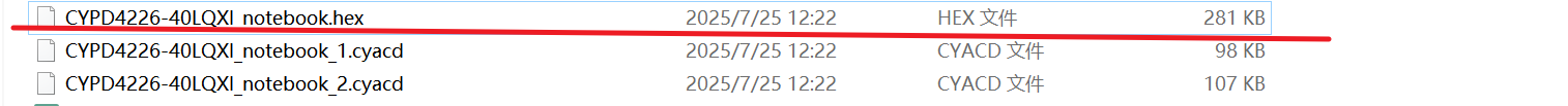

CYPD4226固件烧写失败
你好,我们从 Jetson Linux 35.2.1 | NVIDIA Developer 地址下载了cypd4426的固件(如下图),采用jlink进行下载失败(提示:cypd4226的flash是128KB,但是地址下载的hex文件是280KB),请问这怎么烧写进去啊?

edit: Now that I read the text below and look at your top image in your post it is clearer that you may want *.cyacd file.
CYPD4226-40LQXI_notebook_1.cyacd
CYPD4226-40LQXI_notebook_2.cyacd
original reply follows:

Note that the XML file cannot be programmed to the device. A file with .cyacd extension is saved in the same
folder along with the XML file. Use this file to program the configuration to the device.

Thank you very much, CYPD cannot be burned using JLink.
I had to create a simple account with my address and phone. Then was able to download these 2 programs to a Windows host. I don’t have the cypd4226 hardware so could not test it.
Infineon ezpdhostsdk
Infineon ezpd configuration utility
