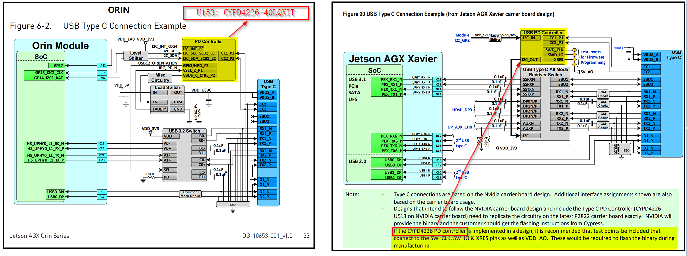

I have check Orin and Xavier design guide.
They all recomment to use Cypress CYPD4226 for PD controller. The notes from Xavier “Required to flash the binary during manufacturing” But Orin design guide dont have any comments for PD Controller.

It is same to Xavier. The statement of Orin will be added in new released DG.
