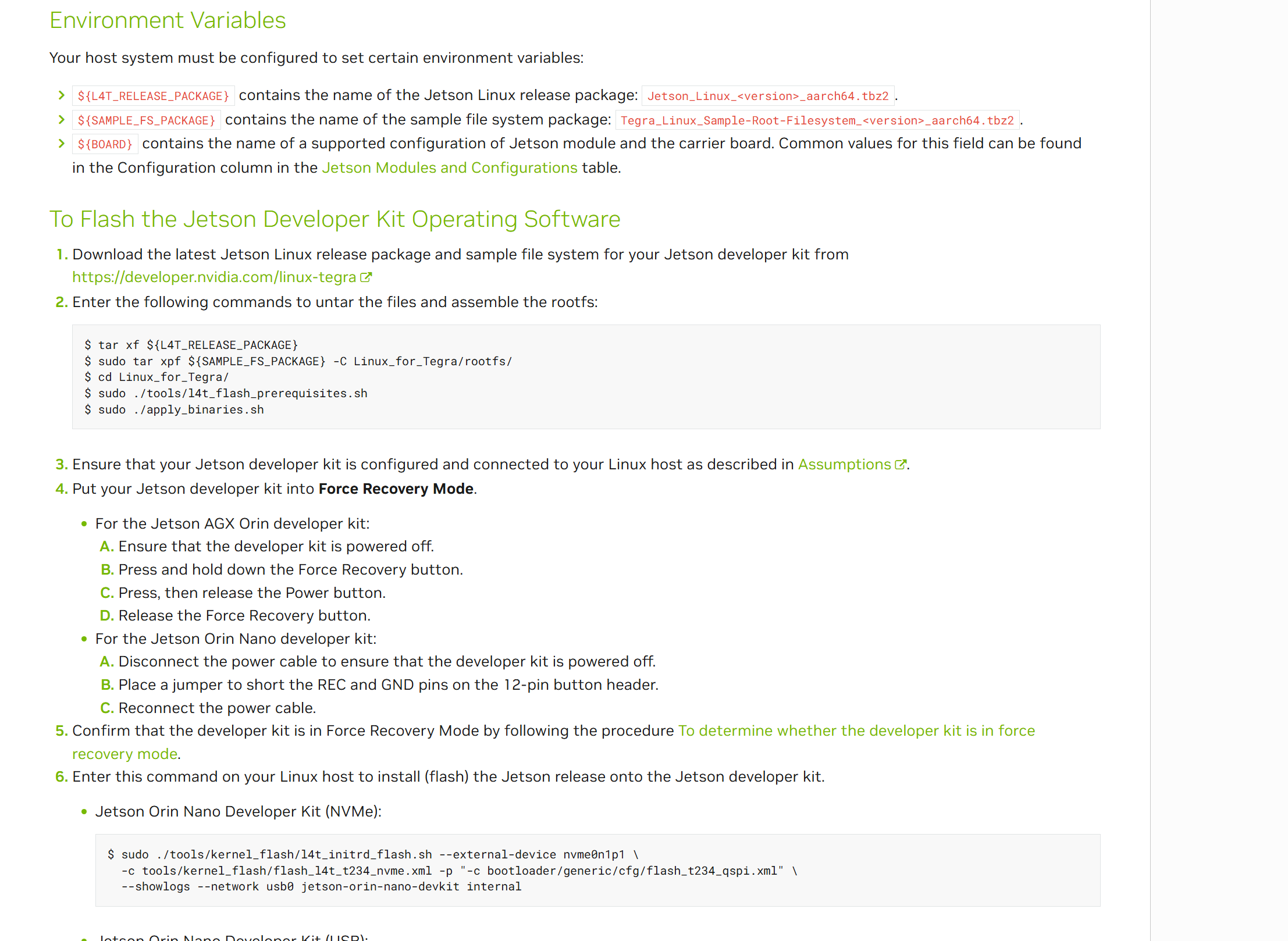

If possible, we would suggest follow quick start in developer guide to re-flash the system:
Quick Start — NVIDIA Jetson Linux Developer Guide 1 documentation
And see if the issue still persists on a clean-flashed system.
