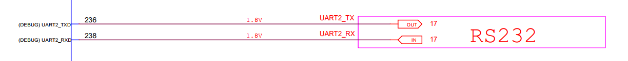

Dear Community,
The serial port of the board is used up, and the 232 is connected to the DEBUG uart, can you turn off the debug function on DEGUB uart?that is, turn off the kernel log on uart.Thanks

I need to disable debug and log output on serial console,and use as normal uart serial port,What should I do?
The project is urgent, thanks
