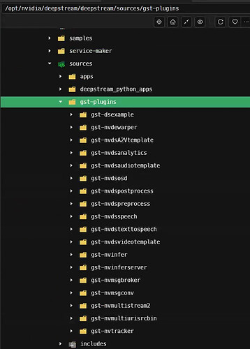

Why is there no "\opt\nvidia\deepstream\deepstream\sources\gst-plugins\gst-nvurisrcbin" directory in my deepstream7.0?
jetson orin nx
gst-nvurisrcbin is opensource from DS7.1.
