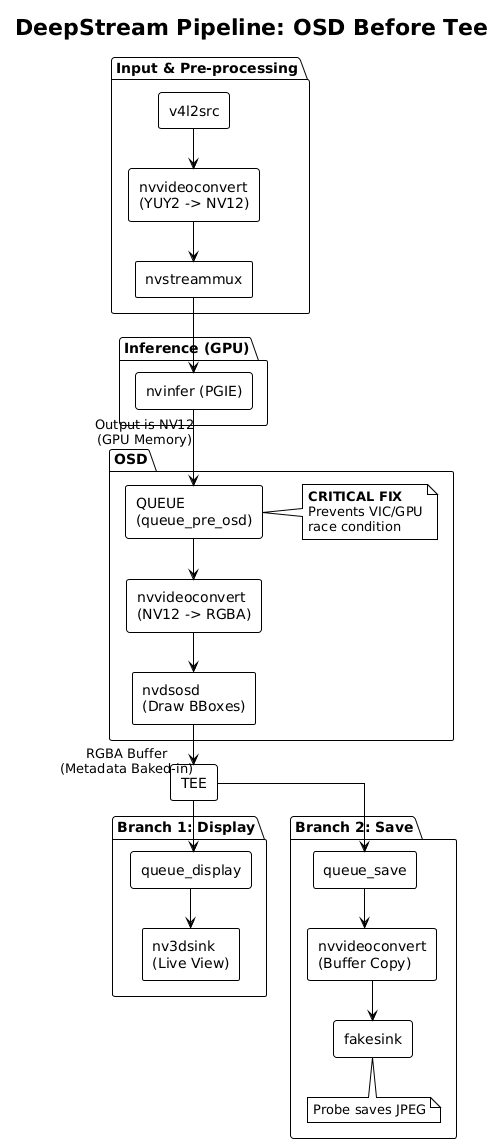

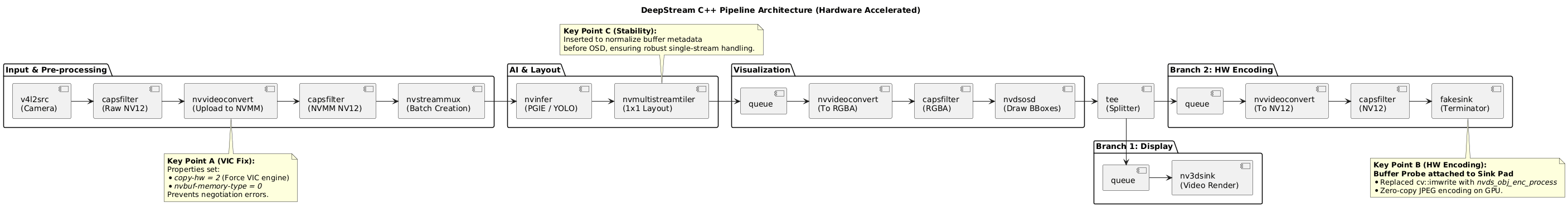

Hi Fiona, thanks for your reply and guidance.
Based on your suggestions, I have modified the code and successfully resolved the stability issues. I ran the DeepStream app continuously for 3 hours without any crashes.
Here is a summary of the specific changes I implemented:
  • Resolved nvvideoconvert negotiation errors: I added g_object_set(..., "copy-hw", 2, NULL); to force the use of the VIC engine on all video converter elements. I also ensured they utilize nvbuf-memory-type 0 (Surface Array) where applicable.
  • Implemented Hardware JPEG Encoding: I removed the OpenCV dependencies (cv::Mat, cv::imwrite) and replaced them with the NVIDIA hardware encoding API (nvds_obj_enc_create_context and nvds_obj_enc_process) inside the probe.
  • Added Tiler: I inserted nvmultistreamtiler into the pipeline between the PGIE and the downstream converters. This ensures stability for current single-stream handling and prepares the architecture for potential multi-stream usage.
I have attached the updated pipeline diagram below for your reference:
