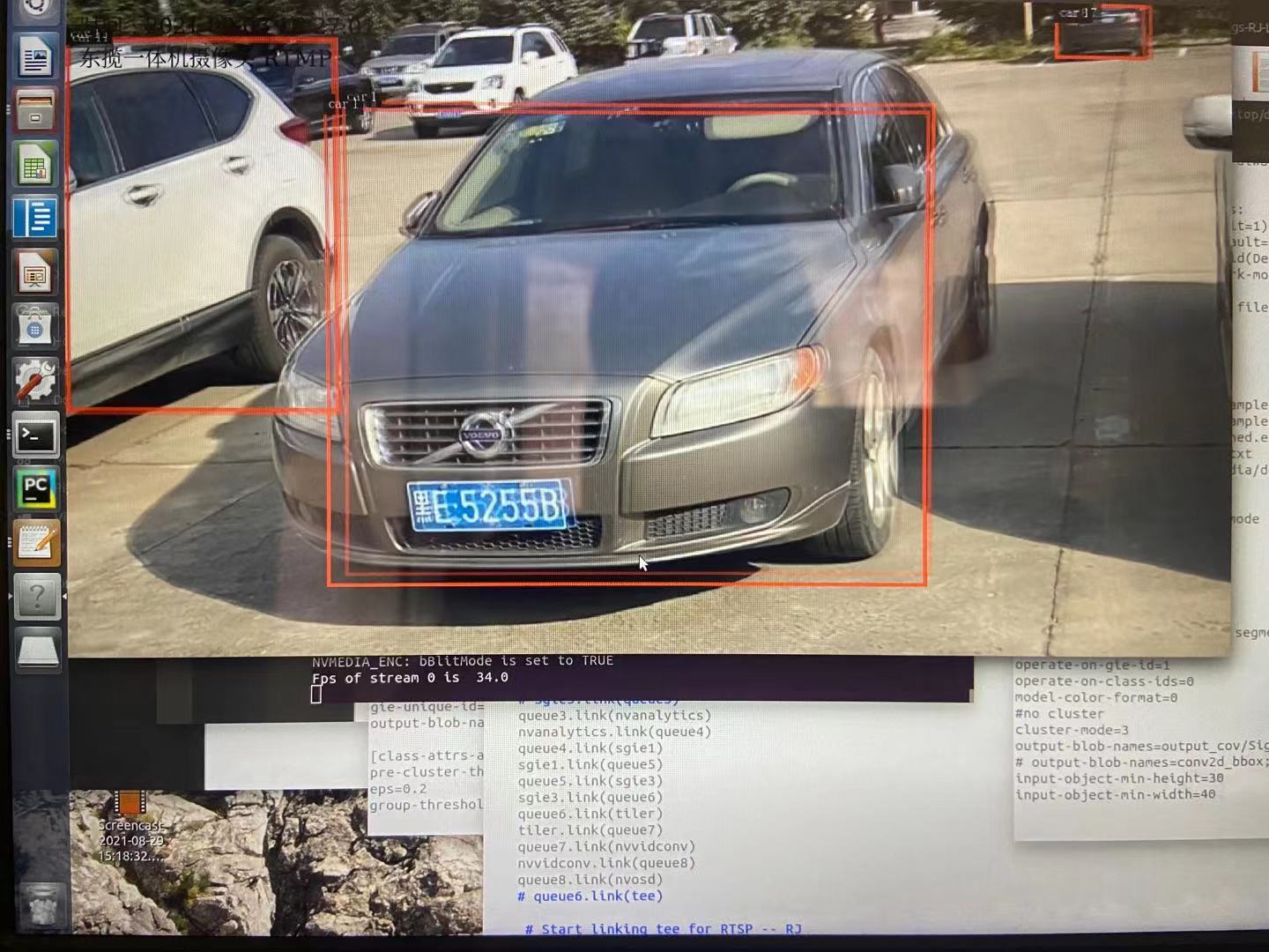

Currently i was trying to insert LPDnet and LPRnet as 2 different sgie into my previous DeepStream pipeline, and i have encountered some problems.
Briefly speaking, i was trying to achieve the function which was shown in the Github repo, after the PGIE inferencing, showing where the car was, and passing down the result to SGIE part to detect the license plate and then passing down to regconize plate number.
Prework:
I have downloaded, converted and coded everything i would be using, engine file, label file, pgie and sgie config, etc. They will be listed at the end of the topic.

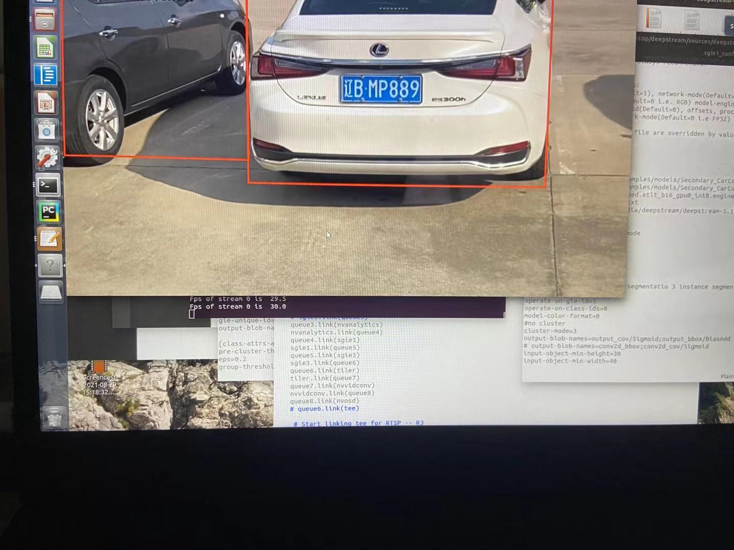

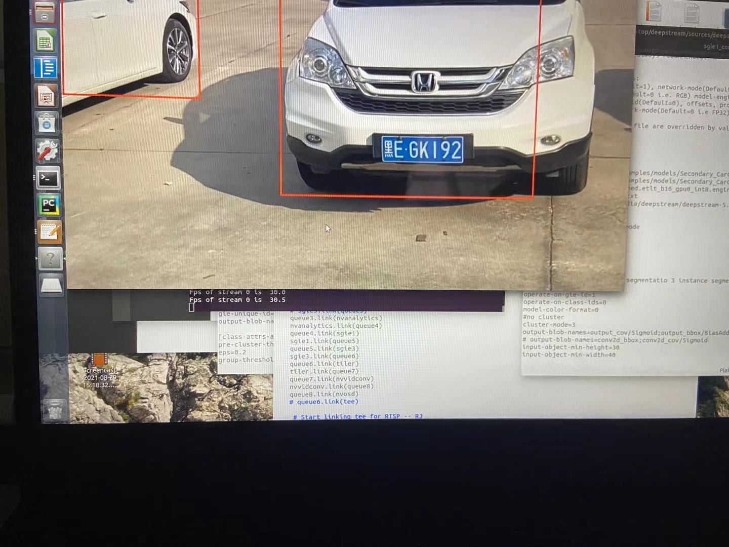

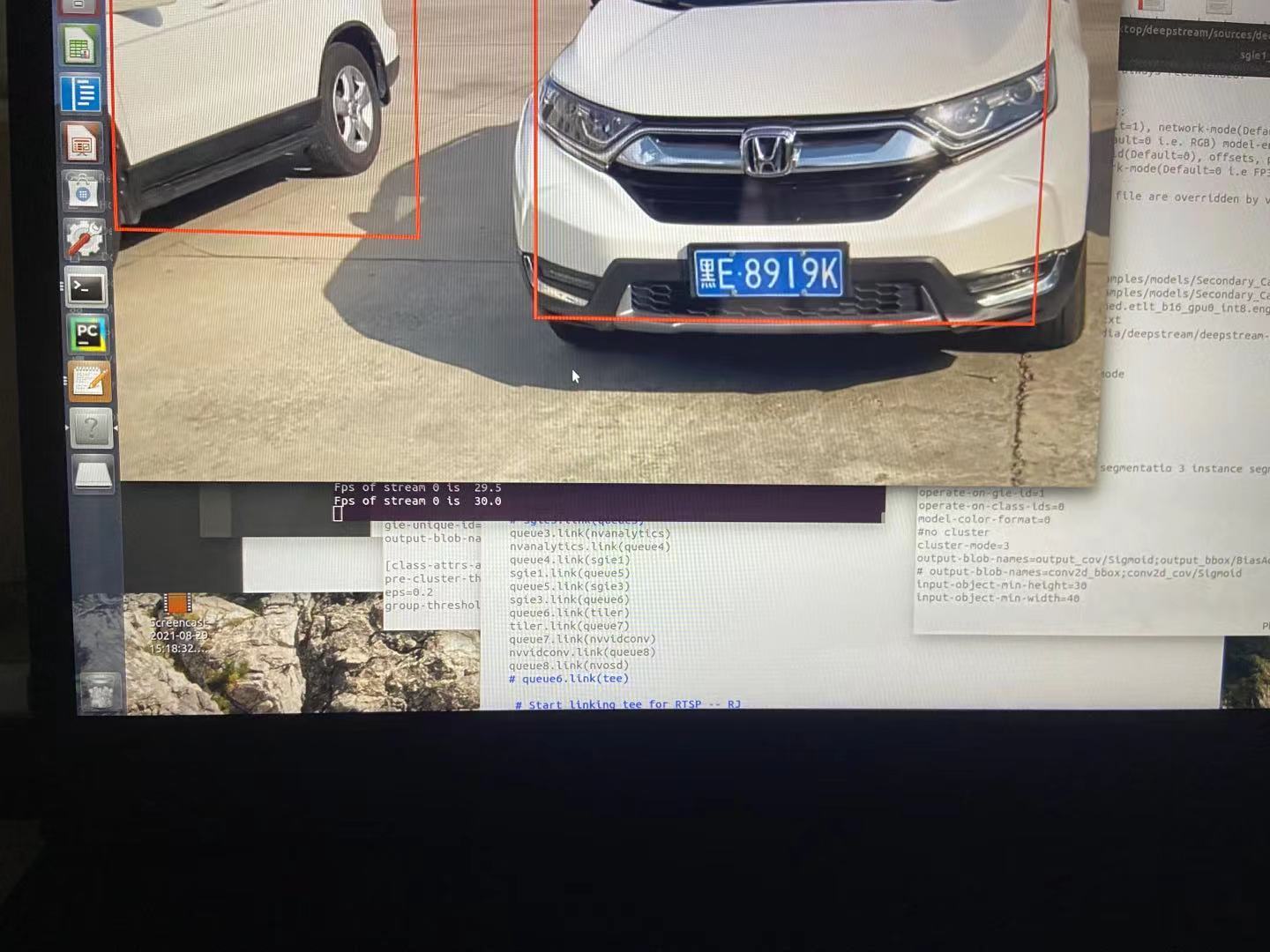

Then something bizzare happened, and i have double-checked almost everthing didn’t see what went wrong. When i was using LPD(License Plate Detector to find where is the plate) as PGIE and LPR(License Plate Regconizor to regconize what the number is) as SGIE, and everything worked just fine, OSD was showing where the license plate is , and what the numbers are. The pipeline i was using: streammux->pgie(LPD)->sgie(LPR)->sink (in short just FYI)
Then i want to insert the LPD and LPR as SGIEs, put them into the pipeline with TrafficCamNet as PGIE. And the result i was hoping to get was:
But the result i got was:
As you can see there was only the PGIE bounding boxes were shown on screen, no licence plate bounding box, no numbers. But i have already adding LPD and LPR as SGIE into the pipeline. The main pipeline and all the inference config are listed below, i am hoping to get some help here, thanks.
Pipeline:
streammux.link(queue1)
queue1.link(pgie)
pgie.link(queue2)
queue2.link(tracker)
tracker.link(queue3)
queue3.link(nvanalytics)
nvanalytics.link(queue4)
queue4.link(sgie1)
sgie1.link(queue5)
queue5.link(sgie2)
sgie2.link(queue6)
queue6.link(tiler)
tiler.link(queue7)
queue7.link(nvvidconv)
nvvidconv.link(queue8)
queue8.link(nvosd)
nvosd.link(tee)
queue9.link(nvvidconv_postosd)
nvvidconv_postosd.link(caps)
caps.link(encoder)
encoder.link(codecparse)
codecparse.link(flvmux)
flvmux.link(sink2)
PGIE config:
[property]
gpu-id=0
model-engine-file=ccpd_pruned.etlt_b16_gpu0_int8.engine
labelfile-path=labels.txt
int8-calib-file=../../../../samples/models/Primary_Detector/cal_trt.bin
force-implicit-batch-dim=1
batch-size=16
process-mode=1
model-color-format=0
network-mode=1
num-detected-classes=4
interval=0
gie-unique-id=1
output-blob-names=conv2d_bbox;conv2d_cov/Sigmoid
[class-attrs-all]
pre-cluster-threshold=0.2
eps=0.2
group-threshold=1
SGIE1 (LPD) config:
[property]
gpu-id=0
net-scale-factor=1
labelfile-path=labels_lpd.txt
batch-size=16
network-mode=1
num-detected-classes=1
##1 Primary 2 Secondary
process-mode=2
interval=0
gie-unique-id=2
#0 detector 1 classifier 2 segmentatio 3 instance segmentation
network-type=0
operate-on-gie-id=1
operate-on-class-ids=0
#no cluster
cluster-mode=3
output-blob-names=output_cov/Sigmoid;output_bbox/BiasAdd
# output-blob-names=conv2d_bbox;conv2d_cov/Sigmoid
input-object-min-height=30
input-object-min-width=40
[class-attrs-all]
pre-cluster-threshold=0.3
roi-top-offset=0
roi-bottom-offset=0
detected-min-w=0
detected-min-h=0
detected-max-w=0
detected-max-h=0
SGIE2 (LPR) config:
[property]
gpu-id=0
model-engine-file=lpr_ch_onnx_b16.engine
labelfile-path=labels_ch.txt
batch-size=16
## 0=FP32, 1=INT8, 2=FP16 mode
network-mode=2
interval=0
num-detected-classes=67
gie-unique-id=4
output-blob-names=output_bbox/BiasAdd;output_cov/Sigmoid
#0=Detection 1=Classifier 2=Segmentation
network-type=1
parse-classifier-func-name=NvDsInferParseCustomNVPlate
custom-lib-path=libnvdsinfer_custom_impl_lpr.so
process-mode=2
operate-on-gie-id=2
net-scale-factor=0.00392156862745098
#net-scale-factor=1.0
#0=RGB 1=BGR 2=GRAY
maintain-aspect-ratio=0
#scaling-compute-hw=2
[class-attrs-all]
threshold=0.5
