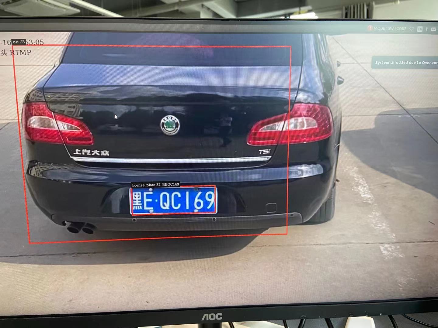

Different trackID between PGIE (car detector) and SGIE (plate detector)
Hardware Platform (Jetson / GPU) Jetson NX
DeepStream Version 5.0
JetPack Version (valid for Jetson only) JetPack 4.5
Early this month i’ve managed to make my deepstream pipeline works to detect cars and their plates, check: DeepStream using TrafficCamNet as PGIE LPR as SGIE.
However i am experiencing new problems recently, hoping i counld get some help here. So long story short, the object_id in PGIE and SGIE were different, so i couldn’t find the one car’s cooresponding plate, i was trying to find a way to preserve the trackID, or some workarounds to match car and plate.
The pipeline i was using is:
streammux.link(queue1)
queue1.link(pgie) # pgie: car detector
pgie.link(queue2)
queue2.link(sgie1)  # sgie1: plate detector
sgie1.link(queue3)
queue3.link(tracker)
tracker.link(sgie2) # sgie2: plate number recognizor
sgie2.link(queue6)
queue6.link(tiler)
tiler.link(queue7)
queue7.link(nvvidconv)
nvvidconv.link(queue8)
queue8.link(nvosd)
nvosd.link(tee)
queue9.link(nvvidconv_postosd)
nvvidconv_postosd.link(caps)
caps.link(encoder)
encoder.link(codecparse)
codecparse.link(flvmux)
flvmux.link(sink2)
The pipeline works, the sgie1 managed to detect the car’s plate after passing down the result coming from pgie. While the trackID was different between PGIE and SGIE:
As you can see for example, in the first picture, black car’s trackID is 43 while its license plate’s trackID is 44. So when i use obj_meta to extract the information it’s hard to match cooreponding plates to the right cars, since their ids are not the same.
But the result was passing down from a pgie to a sgie, is there any connection between the trackID in PGIE and SGIE? So i can match the id result, for example in the second pic, the license_plate 32 is car 33’s SGIE tracking result.

Car and car plate are different objects, each object has its own track id. So what you see in the picture is correct.
There is no relationship between the track ids of PGIE and SGIE.
There is no sub-object data structure in deepstream. So the SGIE detector output ordinary object as PGIE.
If you want to connect the result of SGIE(detector) and PGIE, the suggestion is to use “output-tensor-meta” with your SGIE(detector), so the object is under your control, you can generate our own user meta data to connect the PGIE object with SGIE object besides object meta.
