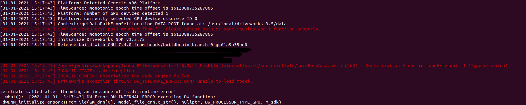

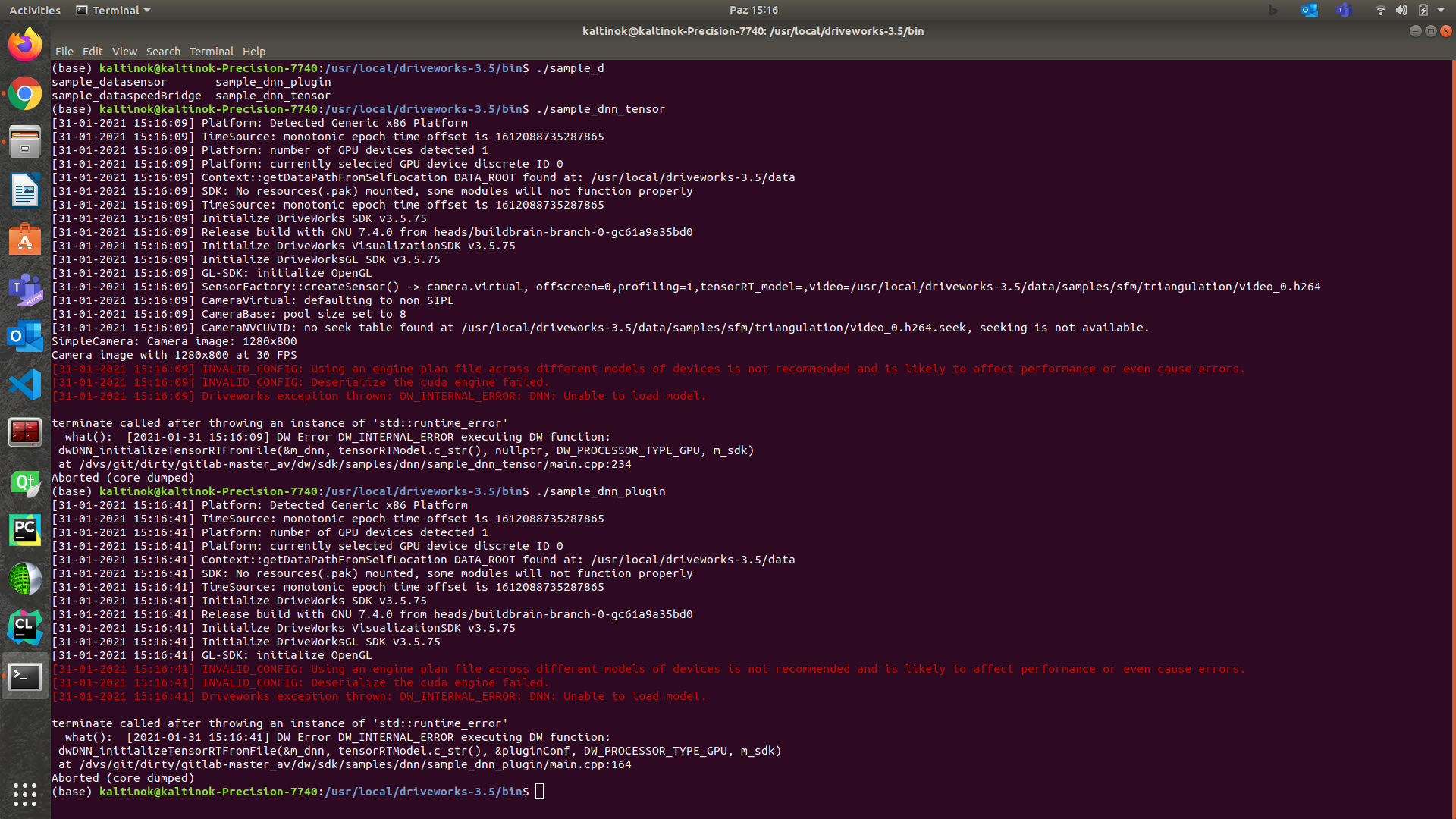

Here you can see the outputs:
First image is from the official samples. And second image is from our custom implementation.
First image:
Second image:
Both gives errors.

Please take a look at “Q: If I build the engine on one GPU and run the engine on another GPU, will this
work?” in “Chapter 14. Troubleshooting” of “NVIDIA DRIVE OS 5.2.0.0 TensorRT
6.3.1 Developer Guide” (at ~/nvidia/nvidia_sdk/DRIVE_OS_5.2.0_SDK_Linux_OS_DDPX/documentations/drive_os_documentation/NVIDIA_DRIVE_OS_5.2_For_TensorRT_6.3.1_Developer_Guide.pdf on host system).
The problem is standard runtime of TensorRT 6.3.1 wronly treats the warning which should be only on proxy/safety runtime. We already fixed it in TensorRT 6.4
On TensorRT 6.3.1, you need to generate and deserialize your plan file with the same GPU. Thanks!
Actually I use the same GPU and still get those errors. I switched back to drive software 10 and in that version those errors are gone.
