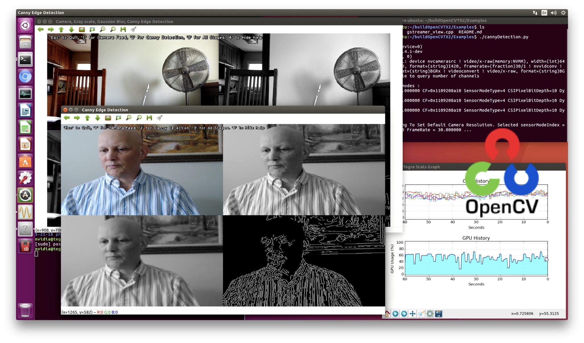

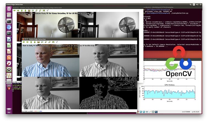

I thought JetPack contained all the OS and the software. I stumbled upon this article from JetsonHacks:
https://www.jetsonhacks.com/2018/05/28/build-opencv-3-4-with-cuda-on-nvidia-jetson-tx2/
What suprised me was under the “Notes” section, I see:
“Most people do NOT have both the JetPack installed and the source built OpenCV on their system. Some people have noted success using both however, check the forums.”
