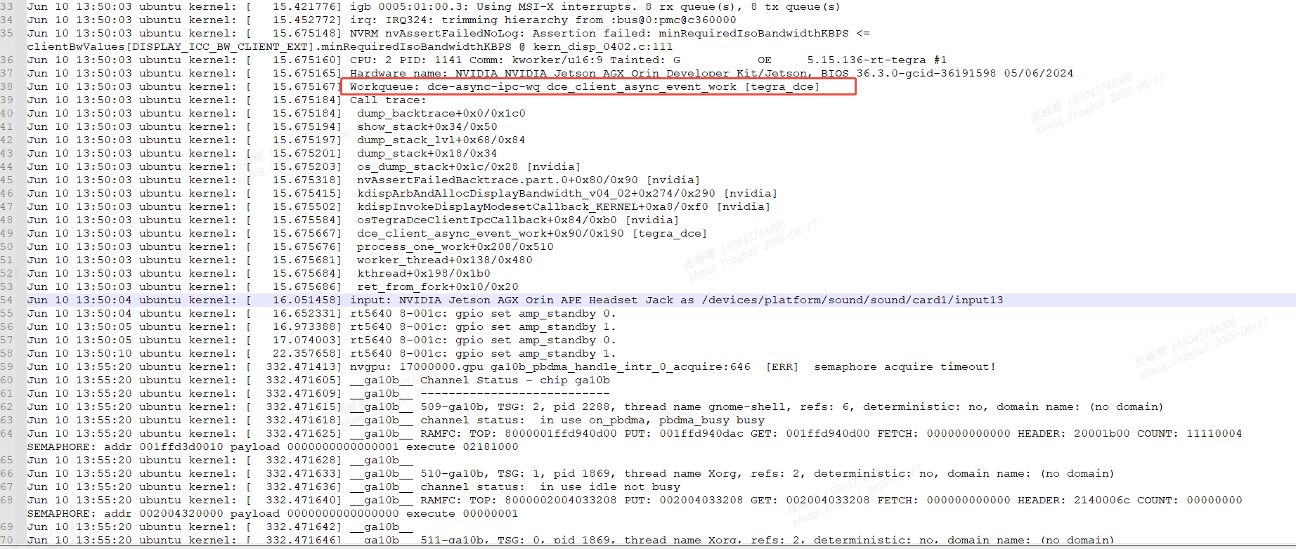

We found the following topic in the forum. It’s exactly the same as our log, but the other party is using version R36.4 while we are on R36.3. Could you provide us with the DCE firmware for R36.3?
I noticed that in its revision, the key-suspend button was removed. Could you explain why this was done?
/delete-node/ &{/gpio-keys/key-suspend};
Relevant forum links:
The issue is specific to Jetpack 6.1. On your system, do you observe it when the system is in suspending and the error is present while resuming the system? Do yo observe the same error on developer kit?

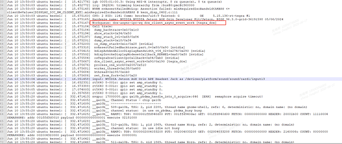

We are using version 6.0 of Jetpack. During the system recovery process, we did not encounter this error. However, when conducting the overall system stress test, we discovered this issue. Additionally, during the wet heat test on the hardware, we also identified similar problems. I will upload the relevant logs here and kindly ask you to assist in analyzing them. Thank you very much.
You can find more abnormal information in the log attachments by using the time range shown in my screenshots or by entering the search keywords.
kern.log (8.7 MB)
Please try to reproduce it on developer kit. If the issue is also present on developer kit, please share us the steps. We will set up and check.
