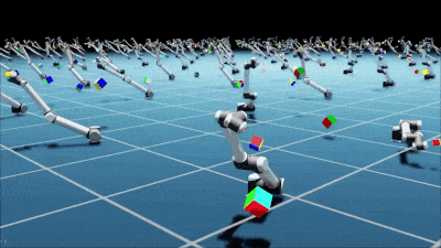

End_effector position can not converged to desired position when i control robot by InverseKinematicsSolver with RL reach task
Hi All,
I am a new user. I want to use ur10 robot to run RL reach task. And I set robot action to task space which means end_effector will move to desire position next step. When I use KinematicsSolver to compute ik solution for joints for next step, I find end_effector can not reach desire position at next step. I don’t know why this happend. I suspect that the position is not convergent because of the fast command frequency, so I try to adjust the simulation step size, but the effect is not obvious.Here is my code.

I don’t know how to solver your problem, but this guy has done what you want:
Thank you for your reply, I’ll take a look.
@1062033103 ,
If you can provide a task space target for which the UR10 IK solver is failing to converge, we can troubleshoot why the IK solver is not working.
In general the IK solver is not designed for continuous control of a robot arm. There is no guarantee that a nearby pose in task space will generate a nearby configuration in joint space. Using a warm-start at the current joint positions will increase the likelihood of finding a nearby configuration, but it is never guaranteed.
Thanks, due to the use of reinforcement learning to send the coordinate position of the end-effector, the position command of each event step is random, which is not convenient to obtain.
I found that some coordinates can approximate convergence, but some deviations are large. For example, the desired position in the picture is the goal position sent by reinforcement learning agent, then it is convert to joint commands by ik solver.The current ee position is the position of end-effector read after step(). It can be seen that the position deviation is relatively large.
