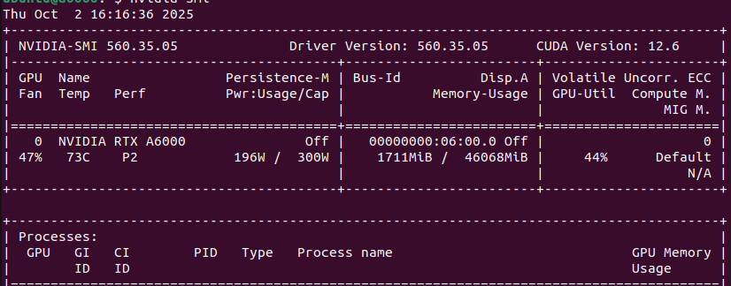

 nvidia-smi
Wed Sep 24 07:56:00 2025
| NVIDIA-SMI 570.124.06             Driver Version: 570.124.06     CUDA Version: 12.8     |
|   0  NVIDIA RTX A6000               Off |   00000000:06:00.0 Off |                    0 |
| 48%   74C    P2            197W /  300W |    1697MiB /  46068MiB |     46%      Default |
|                                         |                        |                  N/A |
|   1  NVIDIA RTX A6000               Off |   00000000:07:00.0 Off |                    0 |
| 30%   31C    P8             17W /  300W |       4MiB /  46068MiB |      0%      Default |
|                                         |                        |                  N/A |

the driver version is not correct for DS7.1. please refer to compatibility table.
Allright, I installed the correct Driver. But I am getting this.
Error parsing GPU utilization: Failed to initialize NVML: Unknown Error
[2025-09-26 16:44:48] �~Z| �~O nvidia-smi failed with exit code: 65280
did you run “nvidia-smi” in host? if so, it seems that driver is not installed correctly. Please uninstall the old driver first, then install the new one, then reboot. Here is the guide to use DeepStream docker.
nvidia-smi works correctly
but still this issue comes up
and it is random. sometimes comes up when I spawn docker container or sometimes hours after the docker has been running
What is your docker start command? In docker container, can deepstream-test1 run well? which DeepStream pipeline causes the error “Error parsing GPU utilization: Failed to initialize NVML”?
