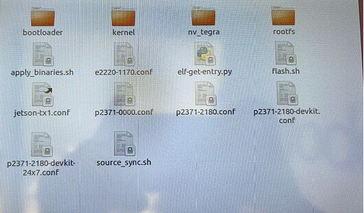

Inside the folder we have the following files:
Do I need to do the ‘make’ command in the Downloads folder?
following the documentation I downloaded the following files:
is one of these?
I see my mistake. The kernel source is not “NVIDIA_Tegra_Linux_Driver_Package.tar”. Usually that is unpacked when manually installing flash software, but what you need is the kernel source. Kernel source produces “`sources/kernel/kernl-4.9’”
The “kernel/” subdirectory within “Linux_for_Tegra/” is part of flash, but is not kernel source.

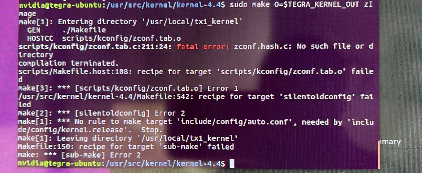

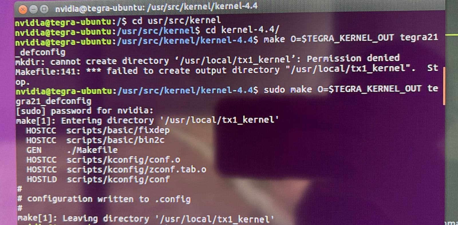

I was able to run the make defconfig command:
the next step according to the documentation would be the make zImage command, but I’m having the following error:
Could you help me?
zImage is a compressed version of Image. When you “make zImage” it first performs “make Image”, then it compresses it to create zImage. zImage has not been used since 32-bit days, and now you only need Image. I think the error might be related to zImage, so build only Image to see if that works.
First, clean up all previous progress from the “$TOP”:
sudo make O=$TEGRA_KERNEL_OUT mrproper
Then configure again:
sudo make O=$TEGRA_KERNEL_OUT tegra21_defconfig
Now try Image:
sudo make O=$TEGRA_KERNEL_OUT Image
I’d erro in Image command:
Could you help me?
Can you attach a full log of that command in the forum? For example:
sudo make O=$TEGRA_KERNEL_OUT tegra21_defconfig 2>&1 | tee log_build.txt

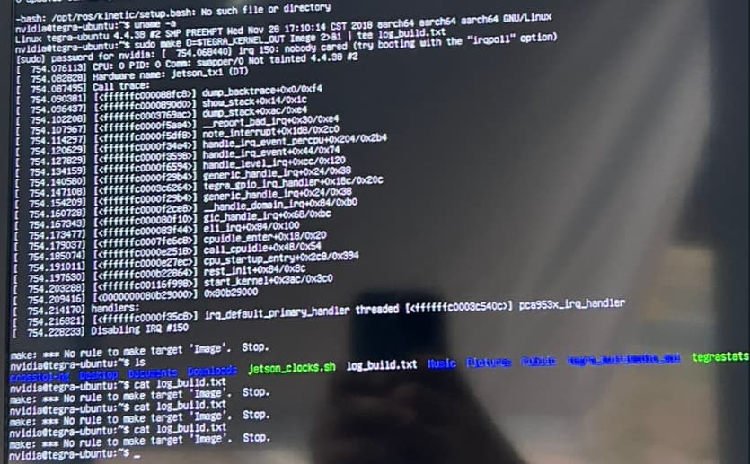

The log_build.txt is not open… I can send you a screenshot
“make NO RULE TO MAKE TARGET ‘image’. STOP.”
You have to keep capital letters: “Image”, not “image”. It is case-sensitive.
I used capital letter in the command. Just when I said in the forum I forgot.
I don’t know why but the result is: “make NO RULE TO MAKE TARGET ‘Image’. STOP.”

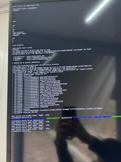

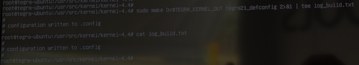

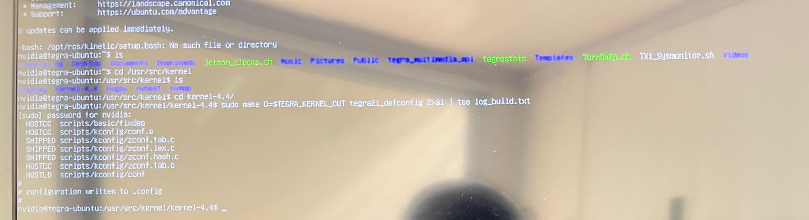

The results of log_build.txt is:
‘#’ configuration written to .config
Can you show this without a screenshot (ignore if the compile issue is now gone)? It is hard to read the screenshot, and it lacks the full log, e.g., “dmesg 2>&1 | tee log_dmesg.txt”, and then attach “log_dmesg.txt” to the forum.
I see a stack frame from a kernel bug related to GPIO IRQ, which should not happen or be related to trying to build a kernel. It makes me think there is something else going on. One example is perhaps forgetting to set “TEGRA_KERNEL_OUT”, which would in turn cause compile output to go to the wrong place. Prior to compile, what do you see from “echo $TEGRA_KERNEL_OUT”? And does the echo location exist? From the compile location, what do you see from “ls”?

log_build from command: sudo make O=$TEGRA_KERNEL_OUT tegra21_defconfig 2>&1 | tee log_build.txt

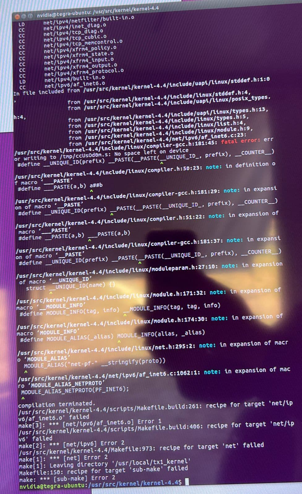

Can you attach “log_build2.txt” to the forum rather than using pastebin? It would be easier. However, it looks like your system disk space is filled:
cannot create temo file for here-document: No space left on device

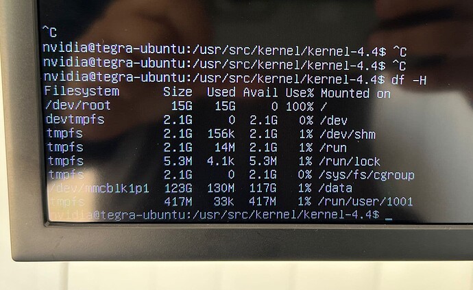

From the location where you compile, plus from the location of “TEGRA_KERNEL_OUT”, what do you see from:
df -H .

Command df -H:
nvidia@tegra-ubuntu:/usp/src/kernel/kernel-4.4$

There is the problem…your procedure is likely 100% correct, but it fails because there is no disk space left. It can’t write. Some content will need to be deleted. For kernel compile there is a lot of space used, and for the moment I suggest to just delete everything in the “$TEGRA_KERNEL_OUT” location (just be sure you’re really deleting from a temp location and not accidentally deleting from the wrong place). Depending on what you have available it is possible perhaps improve space by setting “TEGRA_KERNEL_OUT” to somewhere like:
