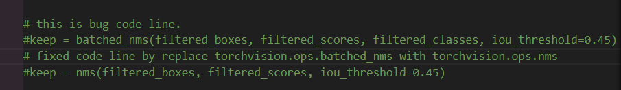

Has this problem been solved? I encountered the same issue when I tried to use the following command to transform the ONNX model: trtexec --onnx=model_data\models.onnx --saveEngine=model_data\models.trt --fp16=False --memPoolSize=workspace:2048.
I’m great happy that i have fixed this issue by replacing my code which is following:
But i still want to know how to solve this issue without change my code which means it’s not suitable for batch image processing.
