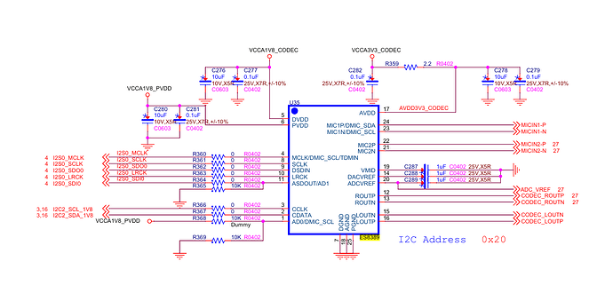

在设备树中如何添加es8389设备树节点
背景:orin nx, jetpack6.2.1, ubuntu22.04, 自研底板,下面是音频部分原来图:
es8389是挂在I2c0下(0x3160000),但es8389在I2S是挂在I2Sx怎么确定
另外这块设备树节点怎么添加,下面是填了一个简单的
/* ES8389 I2C 配置 */
&gen1_i2c {
status = “okay”;
clock-frequency = <400000>;
es8389: es8389@10 {
    compatible = "everest,es8389";
    reg = <0x10>;
    #sound-dai-cells = <0>;
    status = "okay";
/* 启用 tegra_i2s1 */
&tegra_i2s1 {
status = “okay”;
/* 创建独立的简单声卡 - 避免与现有声卡冲突 */
es8389_sound: es8389_sound {
compatible = “simple-audio-card”;
simple-audio-card,name = “ES8389-Audio”;
simple-audio-card,format = “i2s”;
simple-audio-card,mclk-fs = <256>;
    simple-audio-card,cpu {
        sound-dai = <&tegra_i2s3>;
    simple-audio-card,codec {
        sound-dai = <&es8389>;
