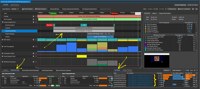

For now, Vulkan is your best bet. Vulkan provides another major advantage – availability of the Real Time Shader Profiler. The following is also from your website.
To make the best use of this, compile your shaders with debug symbols.

Nsight can launch Chrome with Frame Debugger and GPUTrace activity smoothly in Linux during our test, no matter you choose --use-angle=vulkan or --use-angle=gl.
The log looks different and it’s weird that Chrome says “Software only. Hardware acceleration disabled”, can you check that your driver is installed properly in your Linux?
