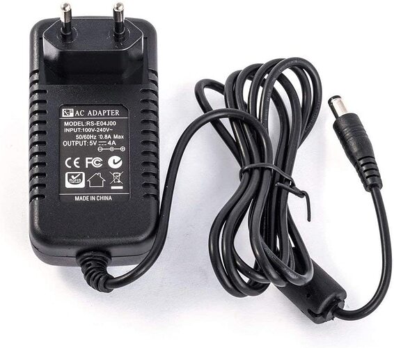

I want to power my Jetson Nano through the DC barrel jack connector to use 10W mode. Sadly, the website and forum only offer verified options for a cable with type A (American) plugs, but I need type C or F because I live in Europe. I found this one searching on Amazon:
Would that do the job?

Hi, for those devices that are not validated officially, we have no recommendation. But you can check Ecosystem for some third-party ones in this site: https://elinux.org/Jetson_Nano. Basically 5V@2.1A should be OK to general power-on, only running heavy load needs 4A input.
