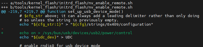

My environment:
Self-developed baseboards based on Jetson Orin Nx core boards
Jetson_Linux_R36.2.0_aarch64.tbz2
VM development environment for sdk - ubuntu20.04
I’ve been able to burn my sdk on the Jetson Orin Nx development board, but when I change it to my own board, I get the timeout problem again!
What is the cause of the timeout problem on our previous board (below) and what should I do to fix it?
What kind of serial port logs are needed, serial port logs for boot-up after flash, or serial port prints during flash?
The following is the serial port log for boot up after a failed flash.
E> I2C: slave not found in slaves.
E> I2C: Could not write 0 bytes to slave: 0x00ae with repeat start true.
E> I2C_DEV: Failed to send register address 0x00000000.
E> I2C_DEV: Could not read 256 registers of size 1 from slave 0xae at 0x00000000 via instance 0.
