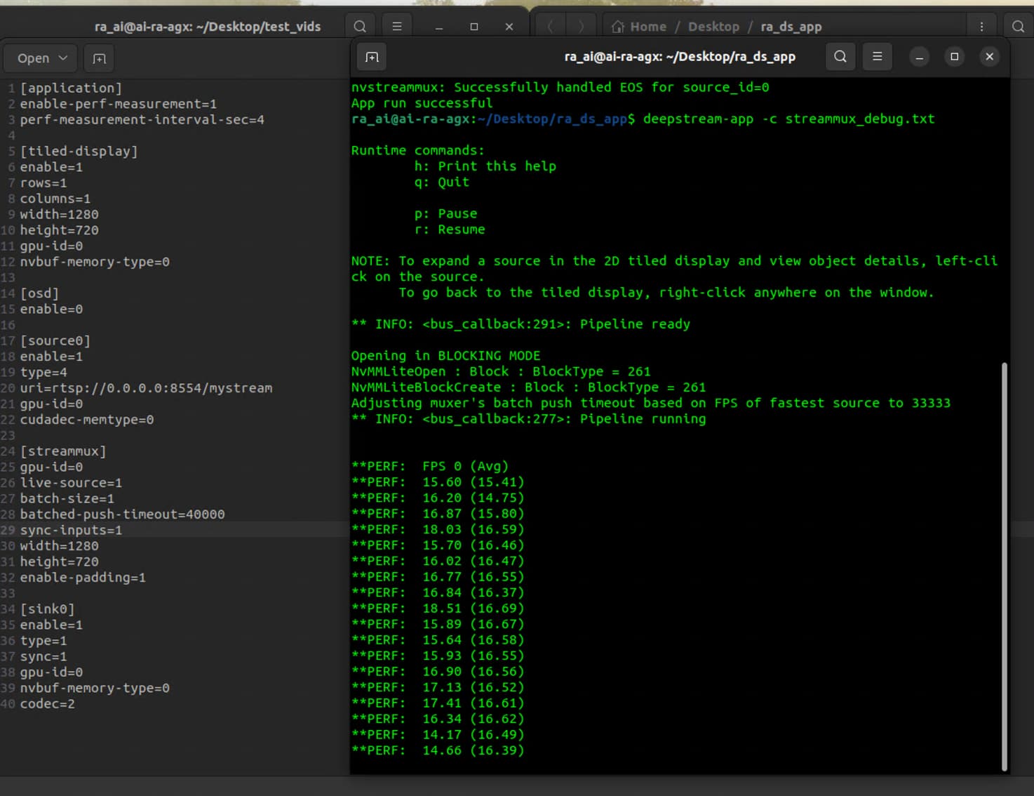

When i use a 25fps@720p rtsp feed with streammux the fps level drops to 20 to 22 without doing any inference. this works fine with 30fps@720p, Since my camera is 720p, I need the streammux to work well on 720p@25fps feed.
I tried following solution of setting sync-inputs=1
but above made it drop the frames even more.
Video works fine when i without streammux.
gst-launch-1.0 rtspsrc location=rtsp://0.0.0.0:8554/mystream ! rtph264depay ! h264parse ! nvv4l2decoder ! nv3dsink
Lag when i use following or deepstream-app
gst-launch-1.0 rtspsrc location=rtsp://0.0.0.0:8554/mystream ! rtph264depay ! h264parse ! nvv4l2decoder ! mux.sink_0 nvstreammux name=mux batch-size=1 width=1280 height=720 batched-push-timeout = 40000 live-source=1 ! nv3dsink

  1. could you share 30 seconds of the following log? wondering the acutal fps.
gst-launch-1.0  -v  rtspsrc location=rtsp://0.0.0.0:8554/mystream ! rtph264depay ! h264parse ! nvv4l2decoder ! fpsdisplaysink video-sink=fakesink  text-overlay=false sync=false |grep current
  1. about “but above made it drop the frames even more.”, could you share the 30 seconds log of the following pipelne with sync-inputs=1? wondering if the otuput fps decreases. will the output video sttutter or lag? please refer to this topic.
gst-launch-1.0 -v rtspsrc location=rtsp://0.0.0.0:8554/mystream ! rtph264depay ! h264parse ! nvv4l2decoder ! mux.sink_0 nvstreammux name=mux batch-size=1 width=1280 height=720 batched-push-timeout = 40000 sync-inputs=1 live-source=1 ! fpsdisplaysink video-sink=fakesink  text-overlay=false sync=false |grep current
  1. Actual FPS

Also Deepstream-app with fakesink
streammux_debug.txt (563 Bytes)
Opening in BLOCKING MODE
NvMMLiteOpen : Block : BlockType = 261
NvMMLiteBlockCreate : Block : BlockType = 261
** INFO: <bus_callback:277>: Pipeline running
**PERF: FPS 0 (Avg)
**PERF: 25.90 (25.59)
**PERF: 19.19 (17.99)
**PERF: 17.09 (17.76)
**PERF: 20.30 (18.72)
**PERF: 17.84 (18.61)
from the printing of the second pipeline, the actual fps is fluent and close to 25. is the video of the following cmd fluent and fine?
gst-launch-1.0 -v rtspsrc location=rtsp://0.0.0.0:8554/mystream ! rtph264depay ! h264parse ! nvv4l2decoder ! mux.sink_0 nvstreammux name=mux batch-size=1 width=1280 height=720 batched-push-timeout = 40000 sync-inputs=1 live-source=1 ! nv3dsnk
yeap it works fine.
log.txt (83.6 KB)
the fps of deeptream-app is a little low. please set sync-inputs=1 for [source0], and set sync=1 for [sink0]. then please check if the output video is fine. if the lag issue persists, please refer to this link for performance improvement.

@fanzh I have followed everything on that. this only happens for 25fps only. i dont see a perfomance bottleneck when i lower the fps to 25 from 30.
why does it sttuter when i lower the fps to 25 frames(my camera is 25fps)
please set type=1 for [sink0] and remove num-extra-surfaces=10.
No improvement
streammux_debug.txt (467 Bytes)

Noticing sync is still 0 for [sink0], is streammux_debug.txt updated?
I updated it sync=0 but no improvement
  1. I mean, please set type=2 and sync=1 for [sink0] to check if the output video still stutter.
  2. if the ouptut video still stutters, you can dump and compare the pipeline graph of using gst-luanch and deepstream-app. AKY, using gst-luanch works well. please refer to this faq for how to dump pipeline.
  1. Video still stutters for type=2, sync=1
