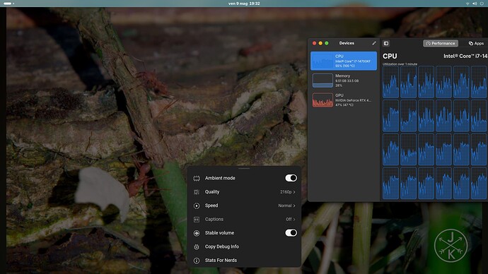

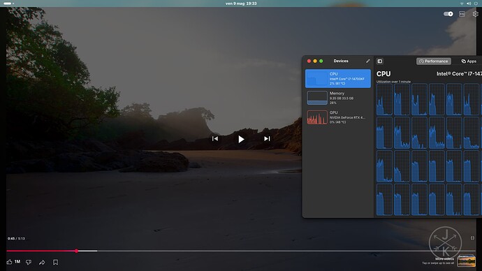

As you can see, I’m playing a 4k video without lag or frame drops and both the CPU and the GPU are being utilized:
And when I pause the video, both the CPU and GPU utilization drops, which proves that Waydroid is NOT running on software rendering.
but when it comes to 3d games (like Roblox) it doesen’t seem to be properly GPU accelerated.
