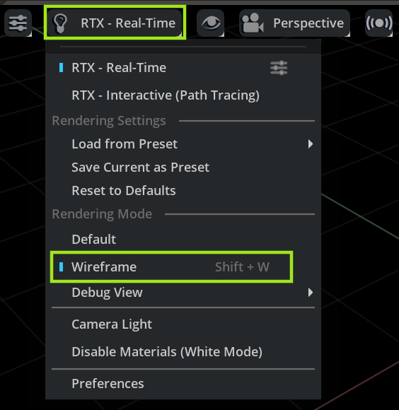

I want to show an object in wireframe mode, my object is a IsaacLab object (loaded in RigidPrim). But I did not find any description about wireframe mode or semitransparent when loading an object, in some cases, wireframe really better sees the contact. So would you mind tell me how to make it ?
@2230580090 the way kit displays wireframe a little differently, and it tends to be global rather than on selected mesh prims (at least in my experience). the shortcut for wireframe is Shift + W or if you were to change it via GUI, it’s part of the viewport setting:

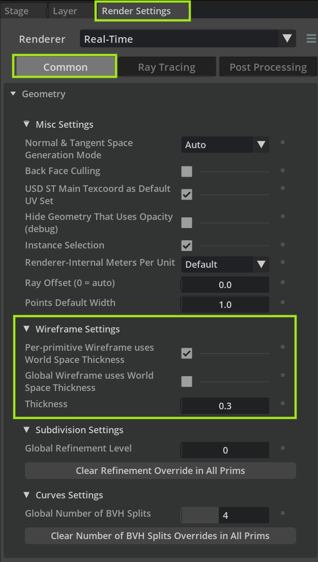

additional wireframe display settings can be configured inside of Render Settings:
and here is one snippet you could use to toggle wireframe visibility programmatically:
import omni.kit.actions.core
action_registry = omni.kit.actions.core.get_action_registry()
action = action_registry.get_action("omni.kit.viewport.actions", "toggle_wireframe")
action.execute()
Thanks for your reply, one specific object can not use wireframe mode.
correct, the viewport wireframe mode is a global effect.
another possibility could be done on a shader level to apply transparency, but that approach could have its own downside depending on the number of mesh prims you are looking to have that effect. transparency can be expensive to render, especially when trying to trace layers of translucent surfaces. if you have a high end GPU, it may be discernible but can take toll on less powerful cards.
