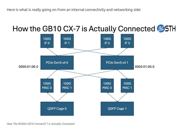

I have a doubt. Each port of GB10 are 200Gbit/s or each one is 100Gbit/s.
So if each one of the 100Gbit/s ports are connected to a single 200Gbit QSFP56 cable to a 400Gbit switcher does the switcher reads 200Gbit or just 100Gbit?
What is the real limit of each port? can they be used in parallel?

You want QSFP56-DD to 2x QSFP56 cables. The -DD is double density and it is a deeper physical connector used on the CRS804/ CRS812 (and lots of other switches.) Here is Rohit’s post on that if you want to learn more: QSFP Versus QSFP-DD Here Are the Key Differences - ServeTheHome - The short answer is that you are just splitting out the double density.
You also have to manually set each port to 200Gbps. The actual PCIe Gen5 x4 throughput you get is closer to 109Gbps IIRC but I might be a bit off there so you lose a small bit of bandwidth by doing both of the PCIe Gen5 x4 links into a single connector. For the GB10, it is well worth it to get higher density on the switch.

It is not a switch issue. This is important context because the CX-7 in the GB10 is a bit funky. The NVIDIA GB10 ConnectX-7 200GbE Networking is Really Different - ServeTheHome
So the GB10 has two PCIe Gen5 x4 interfaces and two physical interfaces. So if you used both ports with 200GbE connections on each port you can actually drive like 109Gbps over one of the PCIe Gen5 x4 links, but you then are provisioning 200Gbps ports for 109Gbps(-ish) of maximum utilization. With the breakout you put both PCIe Gen5 x4 links from the SoC to the CX-7 through one physical port, and then can saturate 200Gbps.
Other than for throughput benchmarking, you are unlikely to notice the difference, so the CRS804 DDQ is a better option since you can do 8x 200Gbps since it is a 1.6T switch. The gotchas are setting things like the MTUs, using the right interface pairs, and then you have to manually set the port speed to 200Gbps on all eight ports.

Here is the fun part. QSFP-112 is 400G as many has already mentioned. But your DGX Spark physical port is only QSFP-56, (200G) and the DGX Spark’s PCIe and Ethernet Interfaces is only 100G (to be generous). So to summarize
QSFP-112 Cable - 400G each
Physical Port - 200G = 200G x 2
Logical Interface - 100G each = 4x100G
PCIE Bus - Total 100G (Practical) / 128G (Theory)
