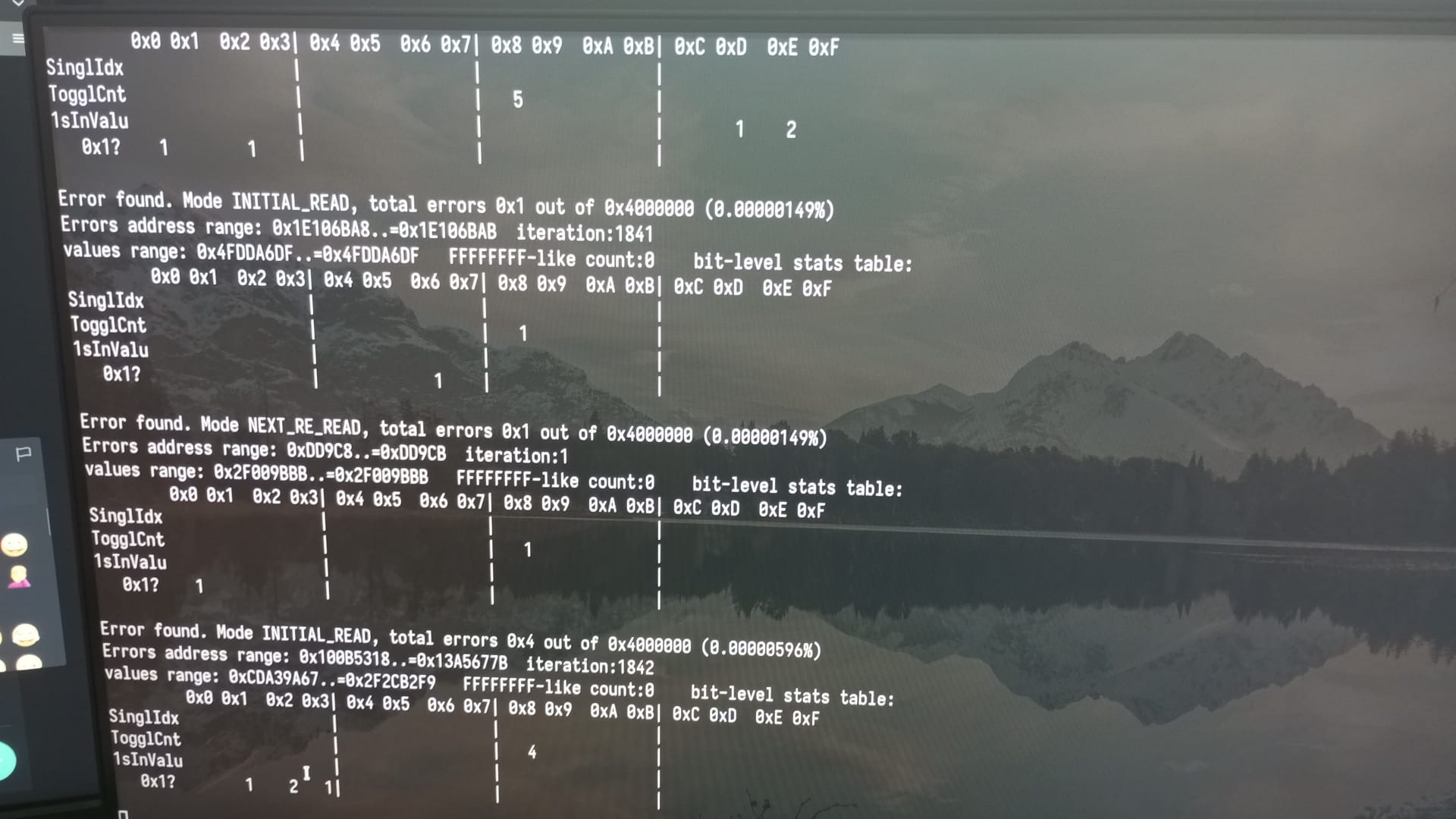

Are those monitor connected to the same gpu?
You might want to check the video memory:
https://github.com/GpuZelenograd/memtest_vulkan
run the tool for both cards ( although it’s confusing if the options are 0 and 1 or 1 and 2 )
we get those results.
no selection (default is card 1 or 0 I guess )
selection 2
the way I’m getting the error now is it starts in 1-2 screens and as I move the mouse to the others, it spreads to those; so when it starts happening I try to quickly open a terminal and reboot (because after a few seconds it all gets stuck and unresponsive so I need to hard reboot)
So the second P620 seems to be broken. Still under warranty? Please create a new nvidia-bug-report.log.
it’s pretty old, there’s no chance I can find a receipt anyway.
