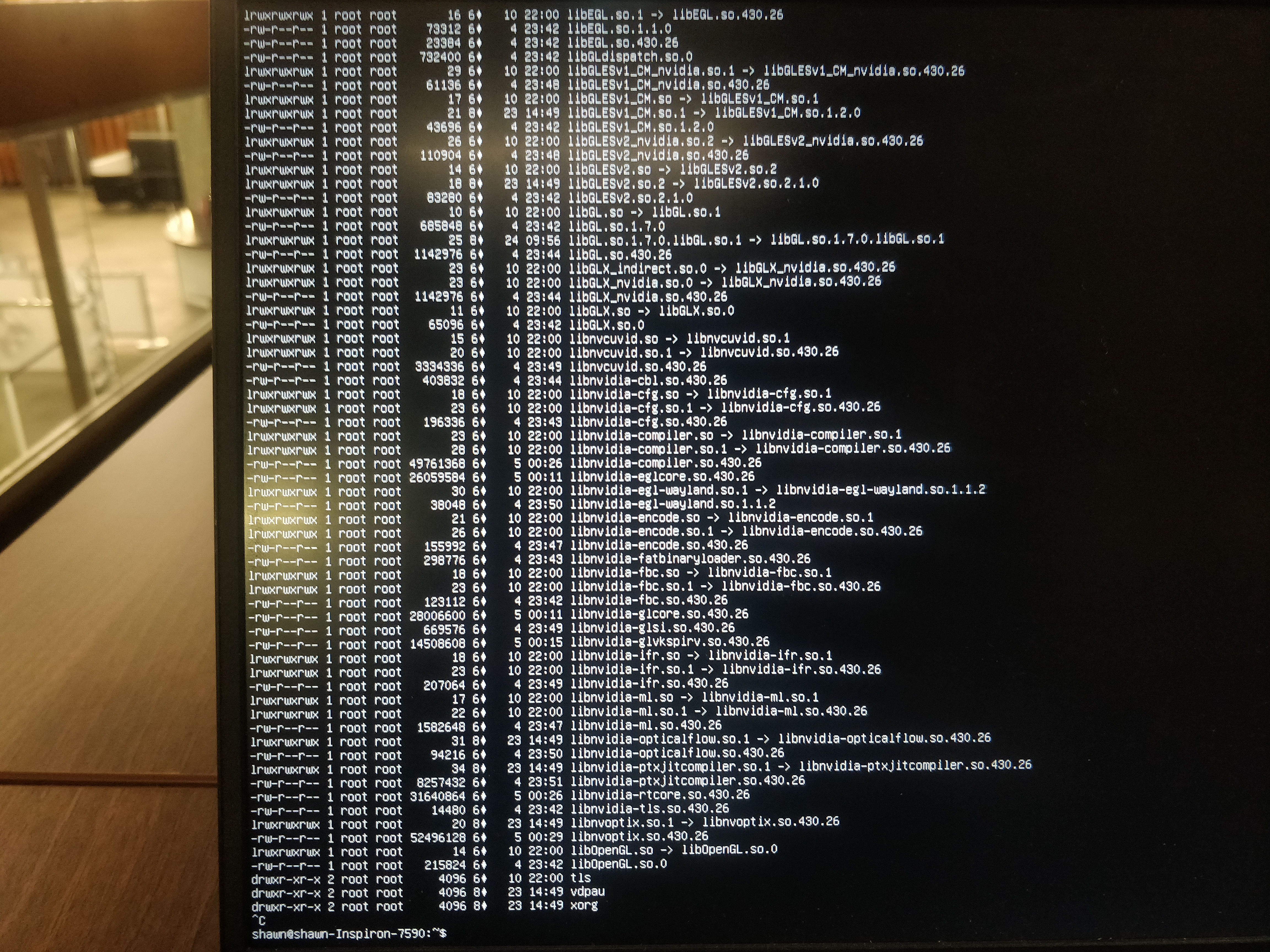

Failed to load /usr/lib/xorg/modules/extensions/libglx.so: libGL.so.1: cannot open shared object file: No such file or directory
means the command
sudo ln -s libGL.so.1.7.0 libGL.so.1
was not properly executed. Please post another output/screenshot of
ls -l /usr/lib/nvidia-430
There are so many items in the folder that they overflow the screen a little, so I take two pictures. sorry for the inconvenience.
You made a typo on first try, please run
cd /usr/lib/nvidia-430
Thank you SOOOOOOOOO much! Finally all work!!!
