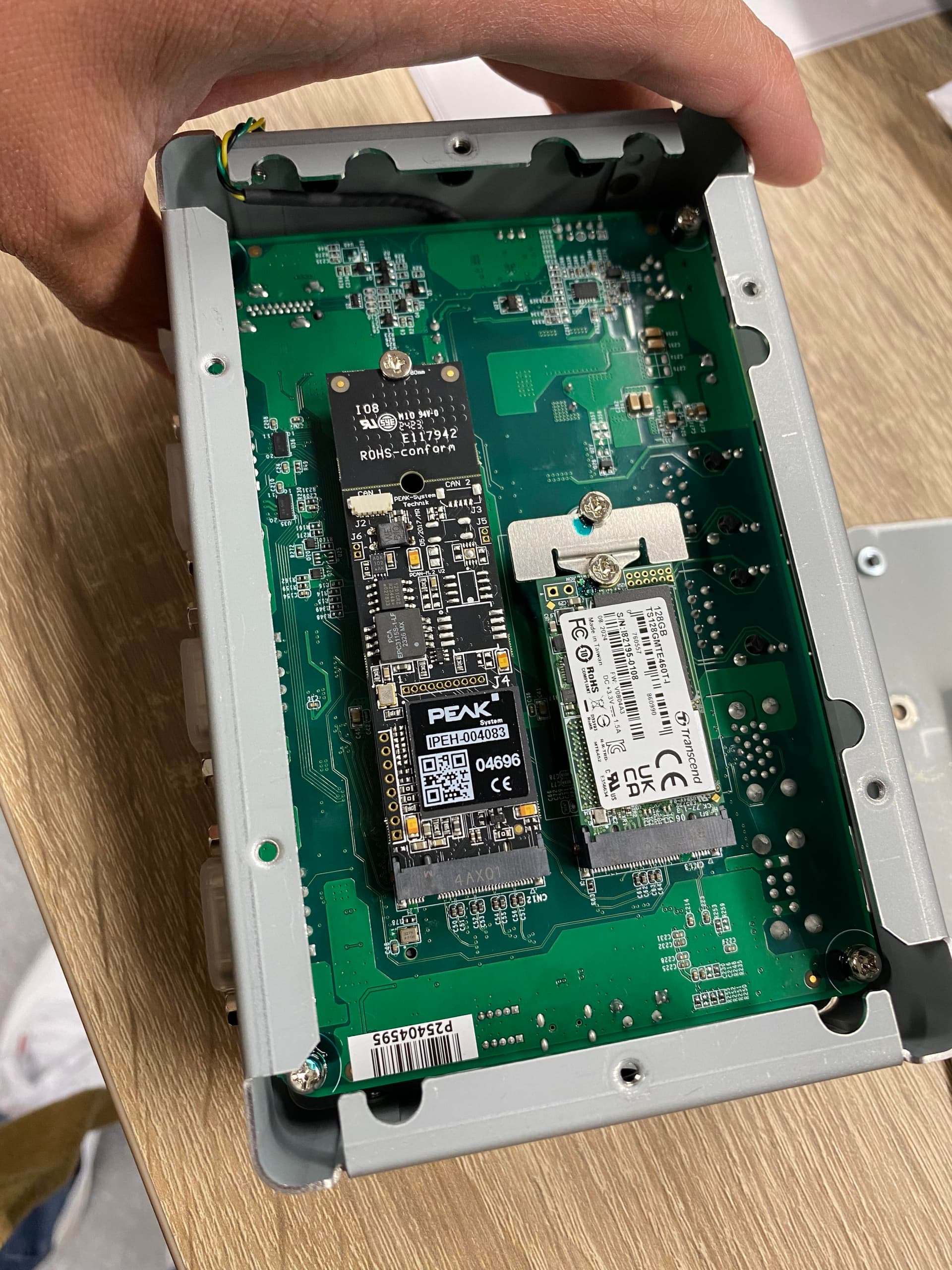

Hello everyone,
I’m sharing a detailed procedure for integrating additional CAN-bus or CAN-FD interfaces on Nvidia Jetson platforms, focusing on my experience with JetPack 6.1.2. This guide should be helpful for anyone looking to add PEAK-System PCAN devices.
  • Jetson Platforms:
    • Nvidia Jetson Orin Nano running JetPack 6.1.2 w/ Aaeon BOXER-8623AI
    • Nvidia Jetson Orin NX running JetPack 6.1.2 w/ Aaeon BOXER-8652AI
  • CAN Interfaces (PEAK-System):
    • PCAN-M.2
My initial expectation was that these PEAK devices would be recognized out-of-the-box via SocketCAN in the mainline Linux kernel. However, on the Jetson platforms with JetPack 6.1.2, this wasn’t the case, since it is not mainline kernel.

I hope this detailed guide helps others looking to add CAN capabilities to their Nvidia Jetson setups! Feel free to ask any questions.
