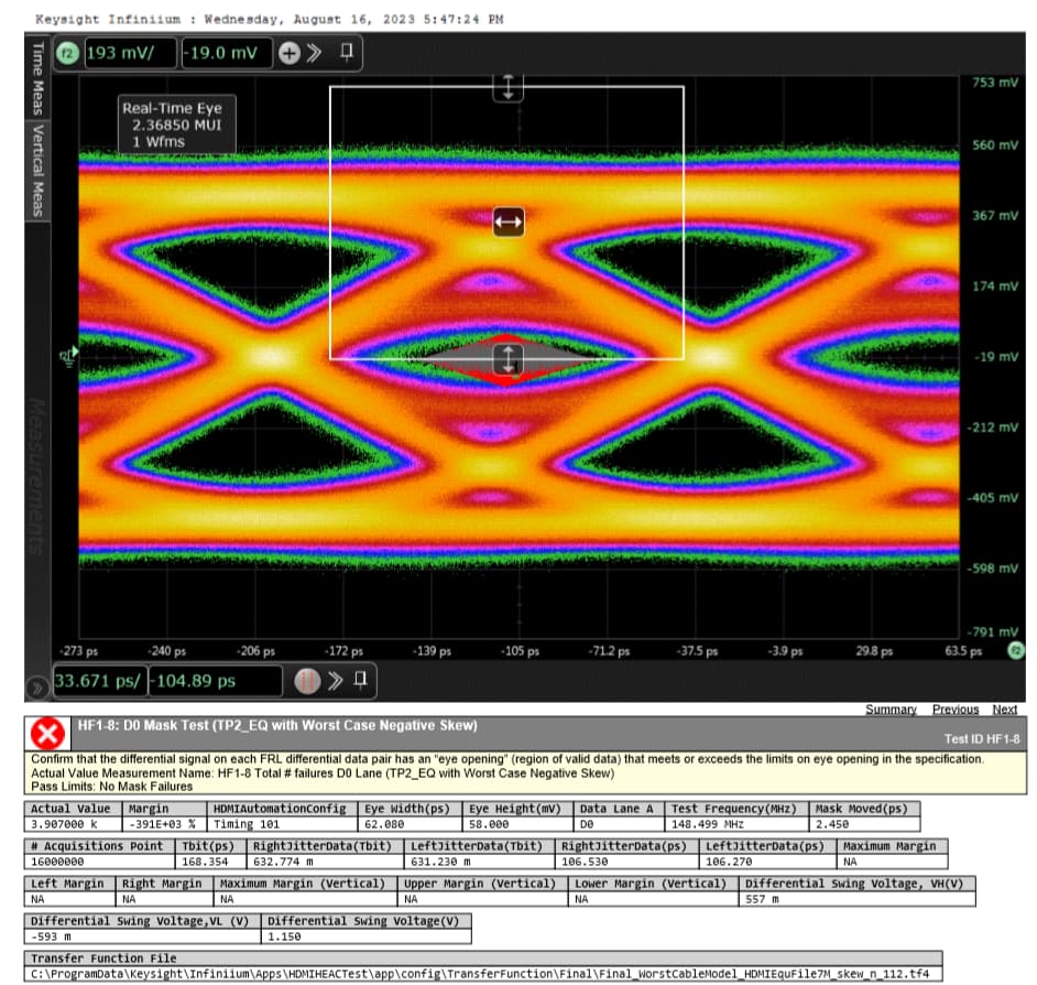

HDMI2.0 compliance test fail on AGX ORIN. I paste the failed test waveform for your reference. Can you give some
advice? Thank you!
Hi, please refer to the Orin tuning guide for HDMI compliance test and tuning.
Hi Trumany,
Where can we get the software tool?What value can we set for drive strength、pre-emphasis ?
Devmem2 is a open source tool.
