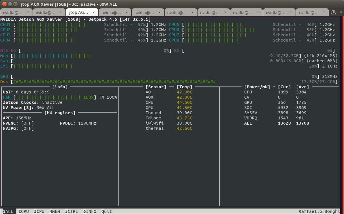

I read frames from 16 cameras at the same time in 16 threads, and I got following performance results:
AGX jetson Mode 30w ALL:
Mode MAXN:
Do the url above used in gstreamer pipe not call hard decode for RTSP stream ? Why I can not see the GPU usage, but CPU usage is so high?

[Gstreamer] nvvidconv, BGR as INPUT
For geneting frame data in BGR format we would need to do conversion on CPU. This takes significant CPU usage.
Do you have some other optional method to do conversion on CPU for BGR frame data, particularly for RTSP stream in jetson AGX ?

Since hardware converter(VIC engine) in Jetson do not support BGR format, so this would need to rely on CPU cores for converting RGBA to BGR. For using cv::Mat, this is the optimal solution on Jetson platforms.
