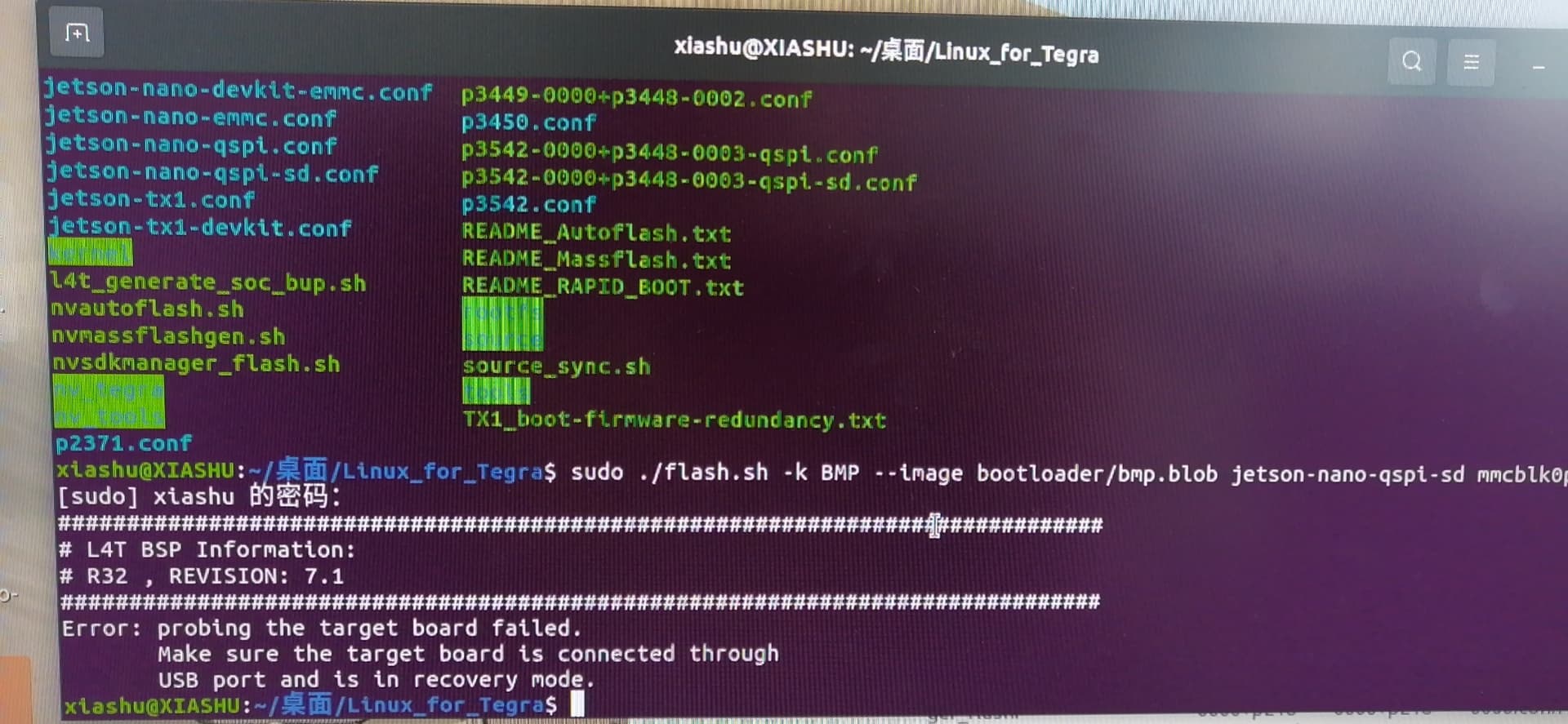

  10. Finish installation by the command: sudo ./flash.sh -k BMP --image bootloader/bmp.blob jetson-nano-qspi-sd mmcblk0p1
I has finish the step10 and get the error:
L4T BSP Information:
R32 , REVISION: 7.1
Error: probing the target board failed.
Make sure the target board is connected through
USB port and is in recovery mode.
now ,i has use zhe linux PC to connect zhe jetson nano 4G,and the question is still .

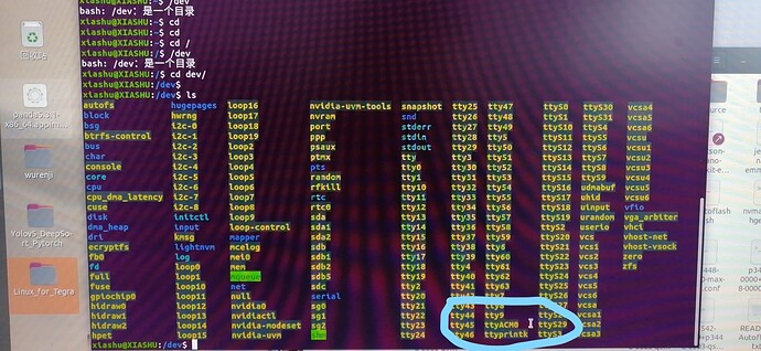

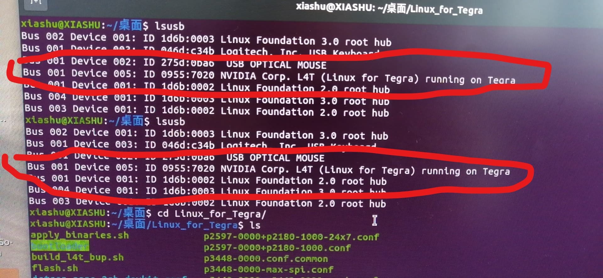

Are you able to see a node /dev/ttyACM0 on your host at this status?
Is your host ubuntu a virtual machine?
yes ,我没有使用虚拟机,这边也可以看见。
so,it‘s very strange.
Could you use
sudo picocom -b 115200 /dev/ttyACM0 and see if you can operate with the board?
no ,i can.
…Then install picocom to your host.
i will be shame for next step…
If you can operate to the device, then it means your board is not in recovery mode…
When the board is in recovery mode, there is no OS running so you are not possible to interact with your board…

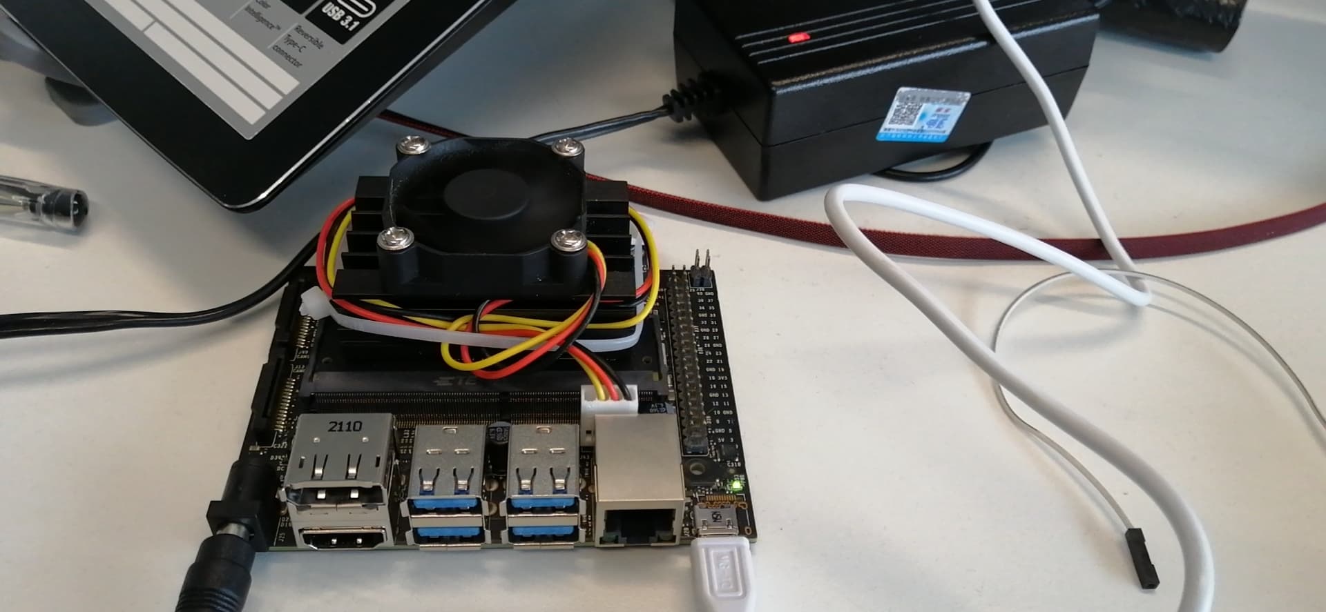

Which pin are you put your jumper on?
10 and GND(?? is 9)
Directly take a photo of those pins.
hi, i jumper on these two pins.
