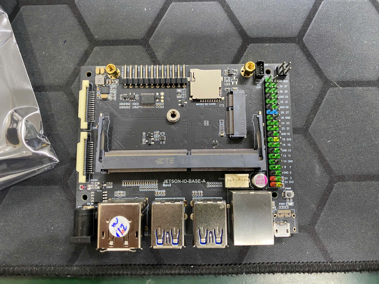

I searched on Ebay and found “Jetson Nano Development Board B01” from the USA.
please tell me if that board is compatible with my Jetson Nano model? I live in Viet Nam, and the Jetson Nano Development Board B01 is traveling from the USA to my project.
The whole process takes 15 working days.
We don’t guarantee anything shipped from Ebay. You may check your local distributor.
Is the JETSON -IO-BASE-A version recommended by the local vendor suitable?
Yes, it could work with B01 board but you need to use the Image from board vendor.
Sdkmanager does not fully support this board.
