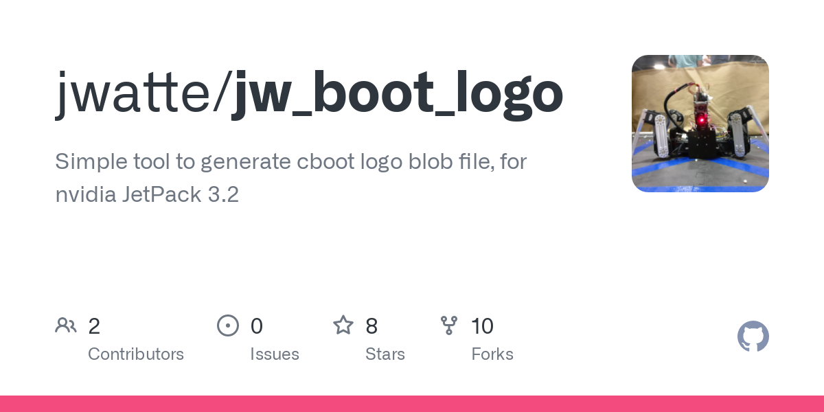

To change the splash screen, this repository might be useful:
And this thread:
Hi @snarky, I use your program. But it creates huge file for my Jetson Nano. I tried different images, and size of a bmp.blob always 9.9 Mb. Size of an original bmp.blob is 71kb. Because of this i have error:
[ 530.5830 ] Writing partition BMP with bmp.blob
[ 530.6640 ] 00000004: Filesize is bigger than partition size
[ 530.6889 ]
Error: Return value 4
Command tegradevflash --pt flash.xml.bin --storageinfo storage_info.bin --create
Failed flashing t210ref.
Thanks in Advance
