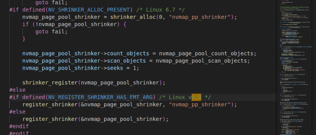

I’ve check that I have these fix lines in my drivers.

I found the problem.
Using v6.6 it’s not working. With 6.7 it’s building well @jonathanh
@jonathanh I’ve completed all the tutorial from page. Now, How to installed to boot?
I have checked our internal builders and I see the drivers are building fine against v6.6.0 and v6.7.0. I don’t see any differences between v6.6.0 and v6.6.14 regard to register_shrinker and so it should build fine for v6.6.x.
