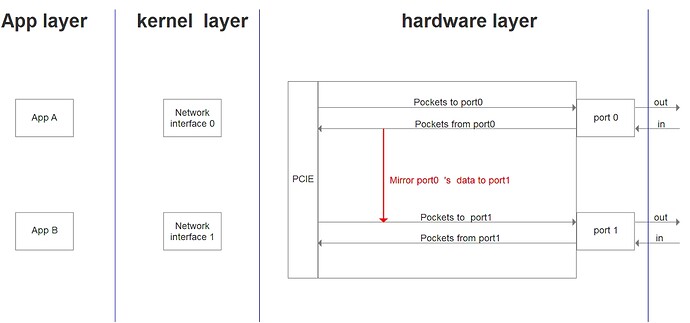

I want to mirror port0’s data to port1 within the hardware, but not through kernel layer or App layer, like the following picture.
Does Mellanox ConnectX-5 can support this feature ?
If it’s yes, how can I configure the feature ?
Thank you.

Hi Saber,
Port Mirroring is Switch feature and can be configured from the switch side
Thanks,
Samer
