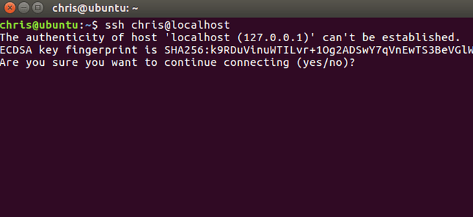

Hello @Victorine ,
You can use ssh connection between them.
