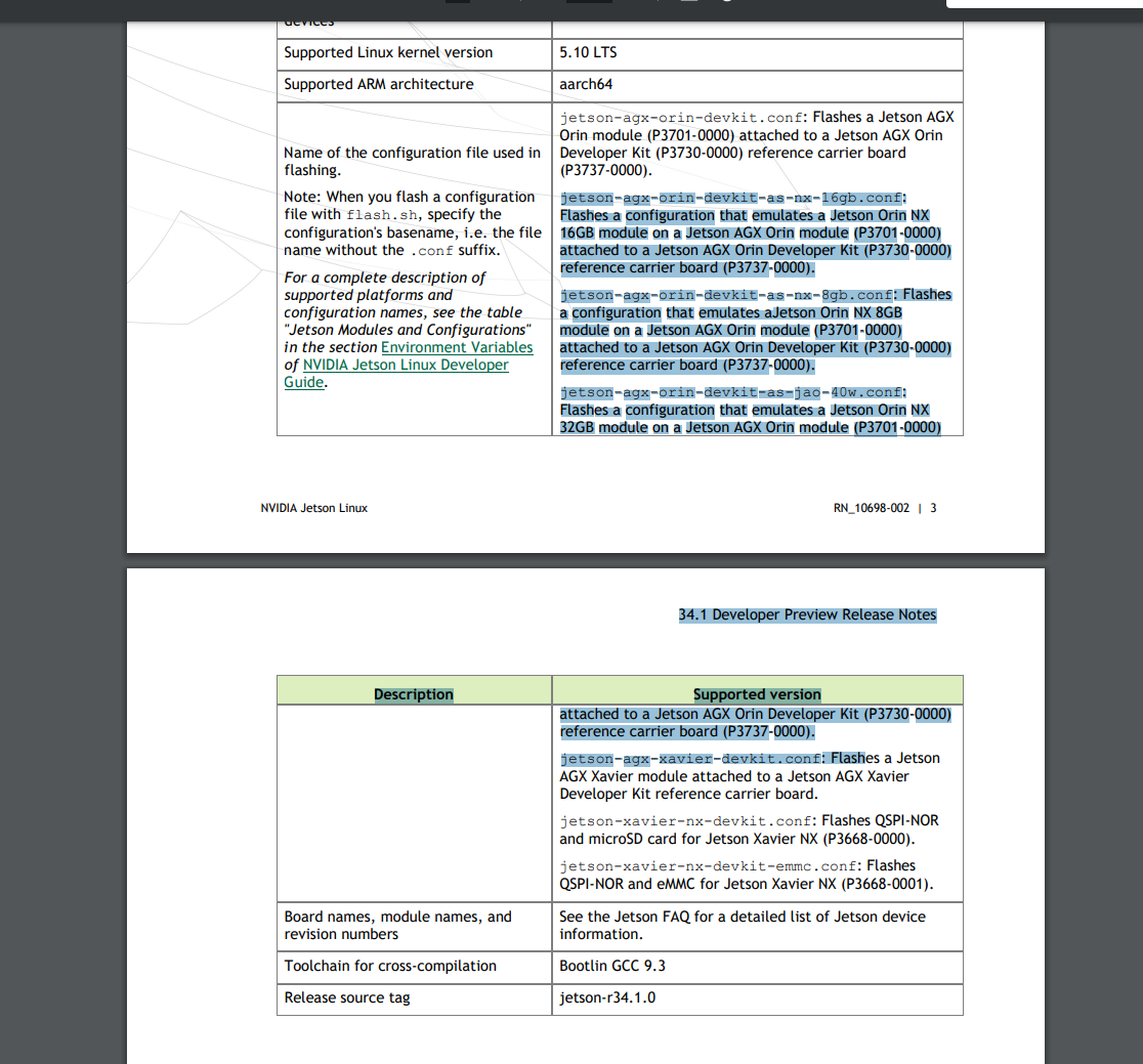

for example this page: https://developer.nvidia.com/embedded/jetson-agx-orin-developer-kit says that: “can emulate the other Jetson Orin modules”. I didn’t find instructions on how to enable the emulation for Orin NX. Could you help with that?
I found instructions for Xavier but not for Orin. Xavier instructions are here: https://developer.download.nvidia.com/assets/embedded/secure/jetson/Xavier%20NX/nv_jetson_agx_xavier_as_jetson_xavier_nx.pdf?pdsbZ89-JUbscpUvmbVQ_LYszoUSykg22P8r0qY5UzK3S5pdJXSqZ2oRpf8yGBuyYdgRPrzD2tSK-d-ctQsKOn4_YrG31Hm__a3XsiiEhNEcaD4nB0tzsLIgN1h7QTEXp0X8TE6MEbKc2RrqHWXMboE3a9VNG6ztsxGDTQlUcqarxBXFkOME52Z2vaPXLALqtb8YR_Y&t=eyJscyI6ImdzZW8iLCJsc2QiOiJodHRwczpcL1wvd3d3Lmdvb2dsZS5jb21cLyJ9
Simply flash the Orin devkit with the right flash config depending on what you want to emulate. It is in the Release notes:
